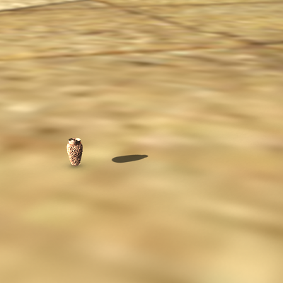

I need a shrink objects but very small objects have weird shadows. Lookin like a breakaway of objects.
Can it be somehow better?
example
Scale 1%
You need to drop the item donw so it is resting on the ground plane and not floating
I know it sounds silly, but this vase is standing on the ground. The following will no longer be under the ground.
400 x 400 - 110K
400 x 400 - 155K

  • Richard HaseltineRichard Haseltine Posts: 112,066
    The main issue is the Shadow Bias setting - assuming this is DAZ Studio that's an offset, in cm, between shadow and object that helps to avoid odd artefacts from self-shadowing. The default is 1cm, which is too high here (though it may be simpler to scale the rest of the sceen up rather than the props down).
  • calaopiecalaopie Posts: 215
    Thanks a lot ,it work :)
