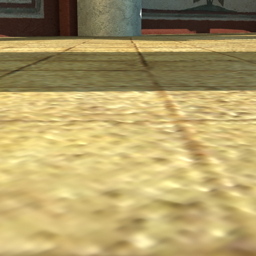

I have a little problem with the floor. After rendering, the floor looks very hilly. Needs a big close-ups on the floor, but such a hill prevent correct setting of different things on the floor. After rendering lookin like floating in the air.
About the shadows have to completely forgotten.
What to do to the floor was more flat?

    What floor exactly is this that you are using?
    The effect that you see, a rough pattern on the floor, is usually done with Bump or Displacement maps in the Surfaces pane. If you want the floor to be completely smooth, you may need to apply a texture or shader yourself to get the desired effect, or remove the Bump or Displacement maps.
    Shadows for all lights are turned off by default. You need to select the light that you are using, then go to the Parameters pane and select 'Shadow' and then select Deep Shadow Map or Raytraced for the Shadow Type. (the default is 'None')

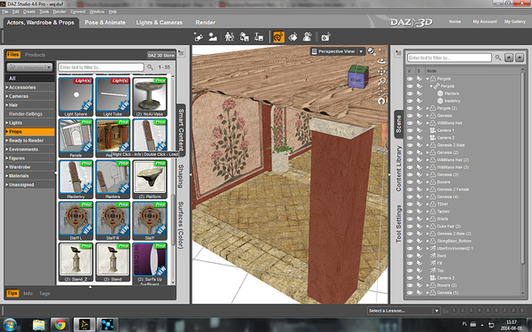

    Like you see i add basic light (uber envi 2 1+ set quality 4x) and 3 point light with raytraced shadows for all.

    Use the surface selector, select the floor and look at the bump and displacement settings. It might be that the mortar is also made through bumps, then I suggest looking at some shader that will have flat tiles and only displaced mortar.
  • calaopiecalaopie Posts: 215
    I turn off bump for the flor and now looks definitive better. Maybe too flat ,but better :)

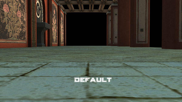

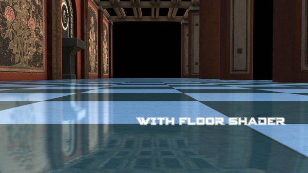

    OK, here is default floor and the floor using a shader.
    The floor suffers from a couple of things:
    (a) The bump/dispmap is just a greyscale of the texture, making the mortar go up, not down, and being one big texturemap it cant work in a closeup. This looks great in a distance though.

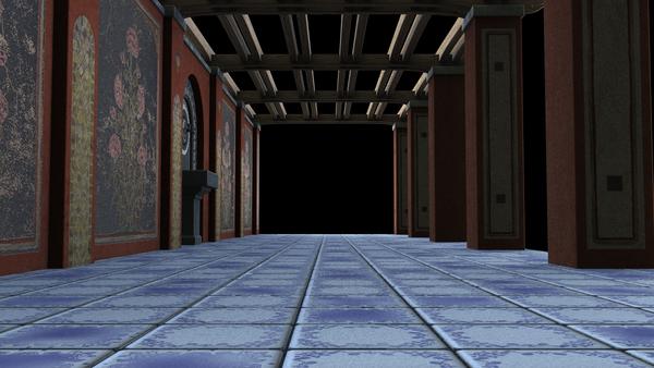

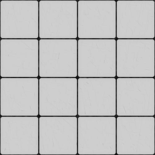

    Made two maps in filter forge, texture and bump. used bump as displacement here
    added the maps for you to play with, set tiling to 10 btw.
