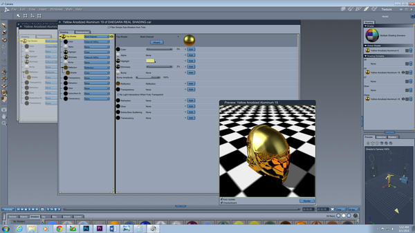

So I'm at a loss. I've tried several different routes but nothing seems to be working for me.
I have my metal shader all settled in, but now I need to paint on top of it...and I need to paint BLACK on top of it. Like as if black spray paint was used on top of the armor, right?
I've tried making JPEG texture maps...but I can't make those in black and have black paint show up, ya know? The base color is black.
Going the 3D paint route similarly yielded zero results because I was basically just painting black on black, which did nothing.
I looked into doing layered shading, but maybe I'm just not getting how that works (how it's supposed to actually layer together). I tried making a transparent PNG texture map in hopes that it would just have the black markings show through, but of course the transparency removed entire pieces of the armor.
I just want to paint black on ON TOP OF the shader layer that's already there. Like, that layer is fine. I just need to put paint on top of it, not *as a part of it*.

    Your shader image, shows a Gold reflective helmet,.
    but you're mentioning painting Black onto a Black surface,. which is confusing,... so i'll move on..
    Firstly, your "diffuse" channel has a value,. Not entirely wrong,, but if you want a specific texture or colours, then those shold be in the main "Diffuse" colour channel.
    the Colur in the reflection channel is what's driving the shader to look "Gold",
    Again,. not entirely wrong,. but there are better ways to use real scene reflections and colouring.
    The Diffuse channel,. (like most channels) can be a "Mixer",. instead of a straight colour or value,.
    For example you have a Brick wall image, and you want Grafitti on that wall,.
    A Mixer will give you two "SOURCES" and a "BLEND" channel
    The First "Source" would be the Brick wall image.
    The second "Source" could be a colour (for the spray paint)
    You'd then create a simple Black and White image,. with your "Graphitti" text
    then you'd add that BW image to the "BLENDER" channel of the Mixer.
    so, what you get is a shader which combines two different textures or colours by using a specific texture, or procedure.
    hope that makes sense :)

    That sounds like what I'm looking for. The writing on a brick wall was exactly the correct analogy. I'll try that.
    As for "what's black". The color of the helmet is black (see the color tab at the top) and the helmet gets all of its "gold" look from its reflection and highlight coloring.

  • 3DAGE3DAGE Posts: 3,321
    My Bad,.
    Carrara calls it the Colour chanel,.
    it's commonly called the difuse channel.
    You should be able to achieve the effect you want,. by creating a Complex shader,. which mixes two complete multichannel shaders together.
    Each shader can have it's own Diffuse / Specular / Reflection / Bump etc..
    So,. you'd make one shader Black and simple.
    then the other shader would be Black with the Colour reflection to make it reflect gold
    Note that BLACK objects don't normally reflect a GOLD colour.,. but in 3D you can generally make unreal materials.
    Your Blender channel will allow you to add a texture maps or procedural shader to separate the two different areas.
    You may also want to considder using two contrasting or opposite colors while you work, to help you see where each shader is being applied.
    Working in a coal mine in the dark isn't easy.
