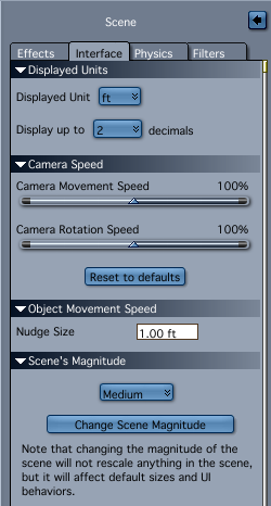

    You should be able to select Scene in the Instances palette, and then at the top of the screen select the Interface tab. I believe you can set the nudge size.
    250 x 466 - 43K
  • DUDUDUDU Posts: 1,945
    EP, you saves me once more the life ! ;-)
