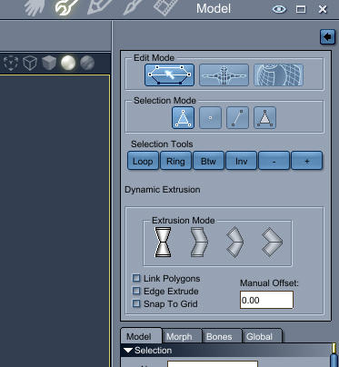

  • 3DAGE3DAGE Posts: 3,320
    HI Gusf1
    When you select the extrude tool,. ..you shoud see some options for the different types of extrusion, in the right hand panels.
    see pic.
    hope it helps
    373 x 404 - 100K
