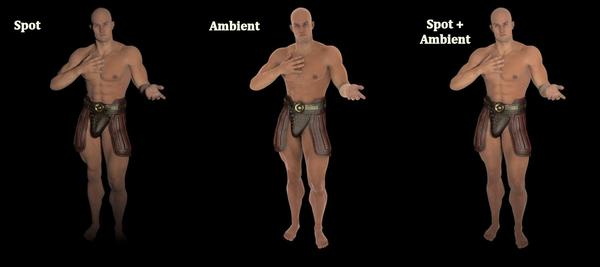

    I did a test render with Gianni and 1 AoA Advance Spot Light, One AoA Advance Ambient light and a combination of the two. I had Flag Surface Shader With set to "None".
    Are there any errors in the log file when you render? Got to Help -> Trouble Shooting -> View Log File. Look at the end of it right after the render and see it there are any msgs that look like errors. You can post them here.

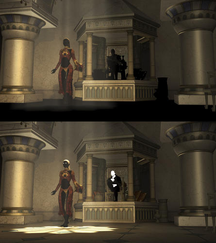

    Hmmm. Good question. It is most common with skin materials, but it occasionally does come up on props and set pieces--most often on a ground plane, in the latter case. The attachment shows what I mean. Often, when I try to fix it, the blackout changes to a whiteout next. I just learned that was a sign of file access problems...
    The second question is intuitive. These problems have usually occurred when I've had multiple windows open; I pretty much have to in order to get any work done since renders (even test renders) take so much time. I can't say I'm happy to discover the problem you mention after dropping a few thousand on DAZ products and resources. I need to be able to keep working (setting up and spot rendering or test rendering) in another instance while another is tied up in a final render. That was my whole reason for upgrading to a multi-core system crammed with as much RAM as I could force in.
    I did look at the log file and found errors referring to missing temp files, so that seems to confirm your earlier warning. I'll be running a solo instance to see if normal behaviour returns. If so, I'm basically screwed anyway, since it will kill my workflow to do nothing every time I render.
