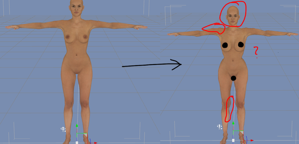

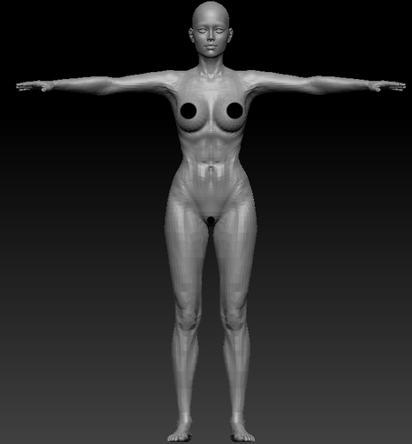

    Thank y'all for the fast answer, I can make morphs now (yayy) but I still get issues :'0 (Im probably dumb...)
    So I made another silly muscle morph (IMG 1) and in ZBrush it looks okay so far but when I make the morph out of the obj (default DAZ units, 1cm) I get very weird results.
    The morphs shrinks the whole figure and doing weird things to the head (I did nothing to the head...). Ahhhh help. No matter which morphs I do (breast, face whatever) I shrinks the whole figure to a weird someting... see IMG2 (enlarge to see what I mean)

    No problem I was too slow, thanks for answering me :) More pictures of the weirdness. So y'all get a better impression. Btw I havent changed her breasts and face at all, but the muscle morph still does weird stuff to my poor girl :0 The last Zbrush snapshot is the morph, I just added some stomach muscles... but yea obviously something weird is going on. Daz is funny.

    Made the morph with Modo scale. Bigfoot is reborn. Gawd have mercy with me. But the morph itself looks clear and somehow good. Gigantic good :)
    Edit: I used GoZ to import to ZBrush, that worked. But reimporting not, somehow. So I exported in Zbrush to obj and used MDL to import the morph. Hope this info is useful. I made anpther mega simple 1-click-pregnant-morph and the same issue occurs (with exporting as DAZ unit and making the morph with the same scale...) See IMG 2
