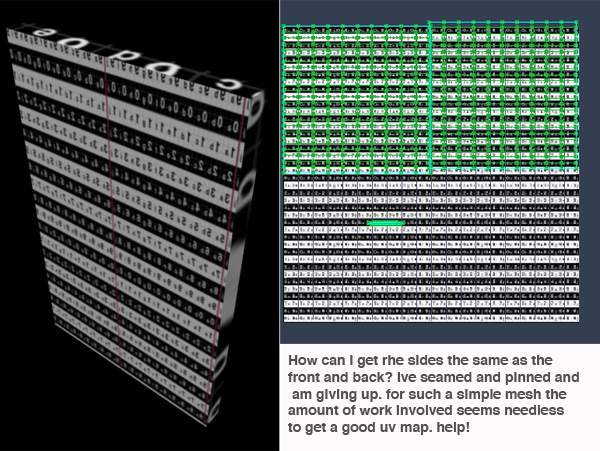

Have tried endless permutations of seams and pins to get the sides to match front and back. simple rectangular shaped cube. i can get sides or back and front but not both.
    What UV mapping option are you using? Cube?
