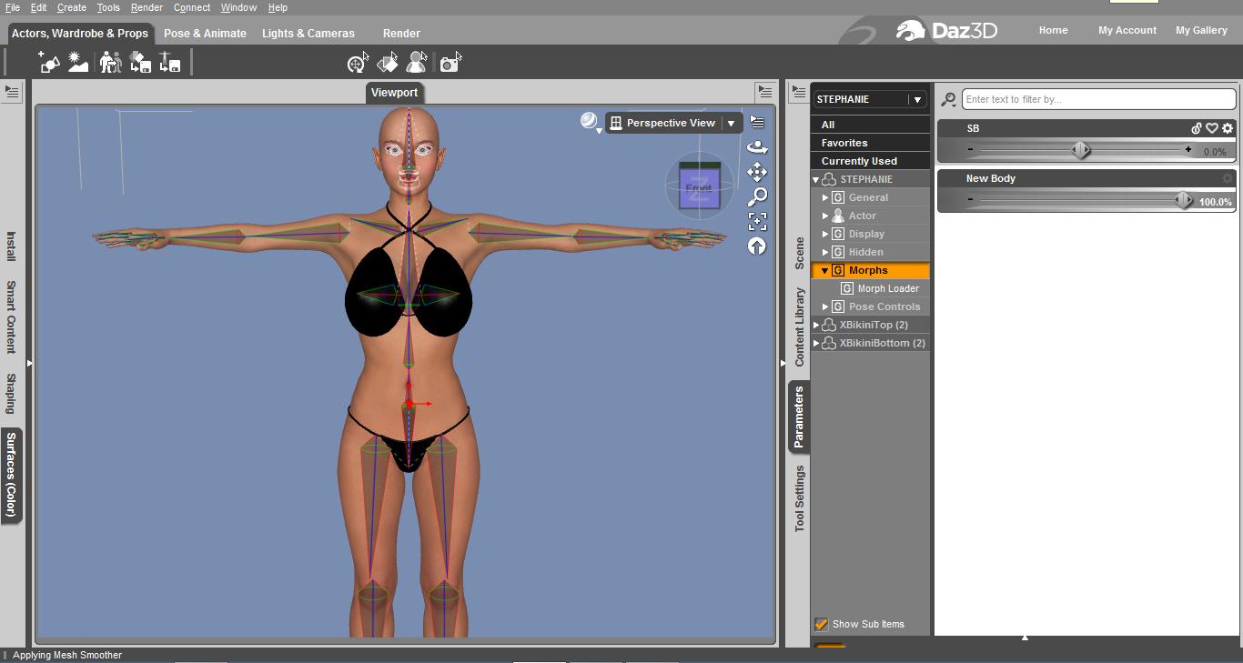

Hello everybody!
Here I am once again! Trying to understand this lovely program called Daz! :)
I'm trying to make an animation of a human form morphing. I used morph loader pro to make the morph slider and it all worked out fine... I'm used to using morph loader pro, but this time, I'm trying to do my first animation of someone slowly morphing. When I move the morph slider the figure distorts cos the the joint (bones) don't adjust with the morphing figure shape... In a still image this is easy to fix. With the Joint Editor Tool I right click on the figure and in Edit I choose Adjust Rigging to Shape and problem solved. But this time it's an animation of a morph what I'm trying to do, and I don't know how I can make the joints adjust to the rig shape automatically in each frame to make an animation.
Does that mean I'd have to go frame by frame adjusting the rigging to the shape to be able to make an animation of a morph that doesn't distort?

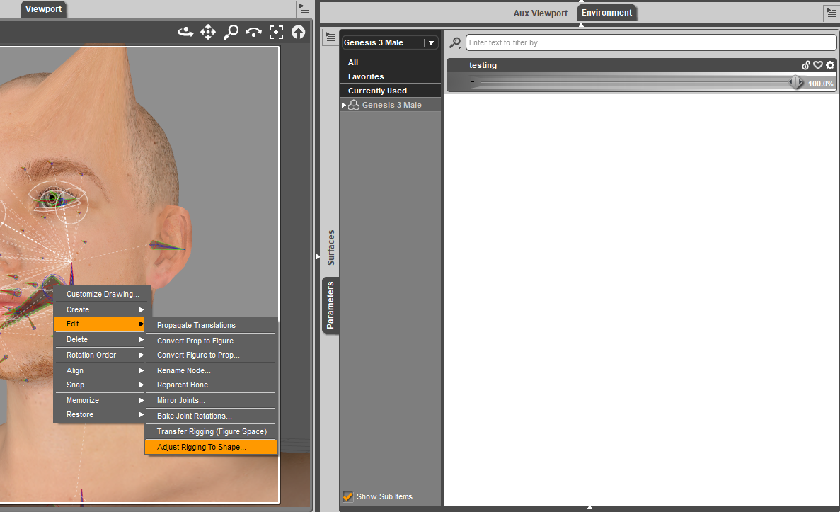

    Hello,
    You need to back up a little and finish making the morph ;-)
    I would suggest loading a fresh figure, then dial in your new morph 100%. On the Parameters Tab right-click on a dial and select Edit Mode. Selecting that bone tool, right-click on a bone and adjust rigging to shape. Wait a second while D/S does that. Then on the new morph dial [it is still set to 100%], it was either a right-click on the top of the slider or via the tool cog ... get the dialog that includes 'ERC Freeze" ... the dialog pops up, I always have the bottom 3 items checked off [some just do the top 2 - whatever works for you] {that's for the previous popup for adjusting the bones} and click accept. Then resave your morph to the EXACT same folders as it was ever first saved to. [2 morphs with the same name will not be recognized/work in D/S].
    Now then when you animate your figure it should work as desired :-)

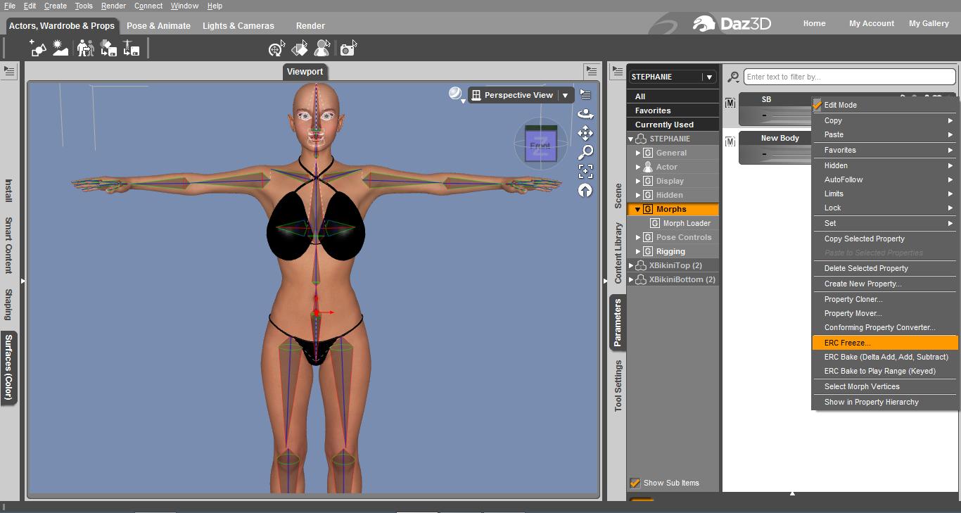

    Sounds like you missed a check mark.
    ERC freeze is done with the morph dialed in 100%. Morphs are dialed to 0% to save them of course [otherwise they'll load dialed into every character].
    I'll get a screenshot of ERC for you.
    edited October 2020

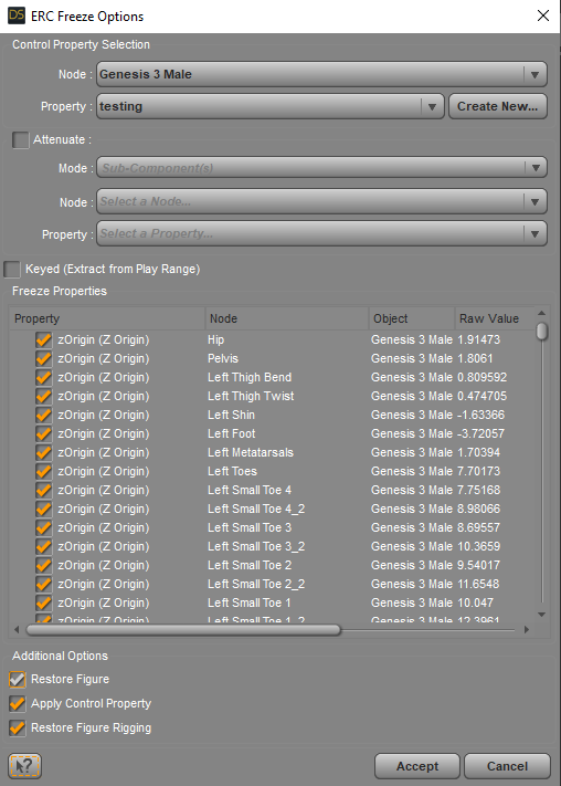

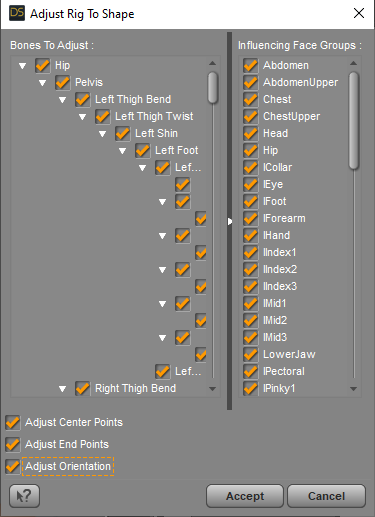

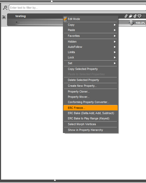

    Okay, in winging it I missed a popup ... it's in the first popup that some omit the last checkmark. {Some also uncheck various bones.} However in the ERC popup that last box must be checked. {I leave everything else checked and my morphs seem to work just fine}
    This is the place where some [so I feel I should mention it] do not check off the last box. May or not affect fingers or something.
    It's a right-click on the dial option.
    Must have that last option checked for the rigging to be restored when the morph is dialed out ;-)

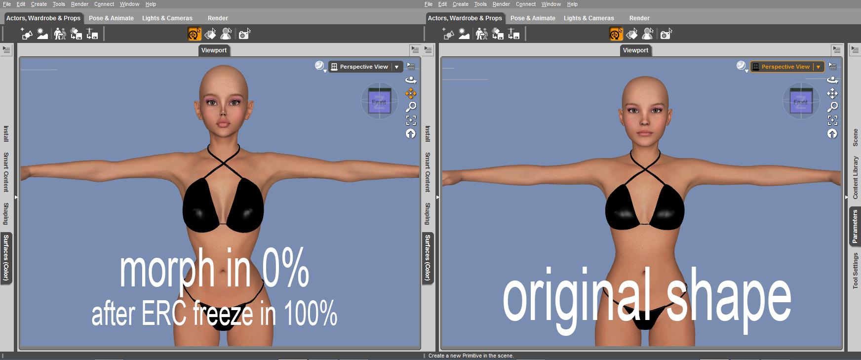

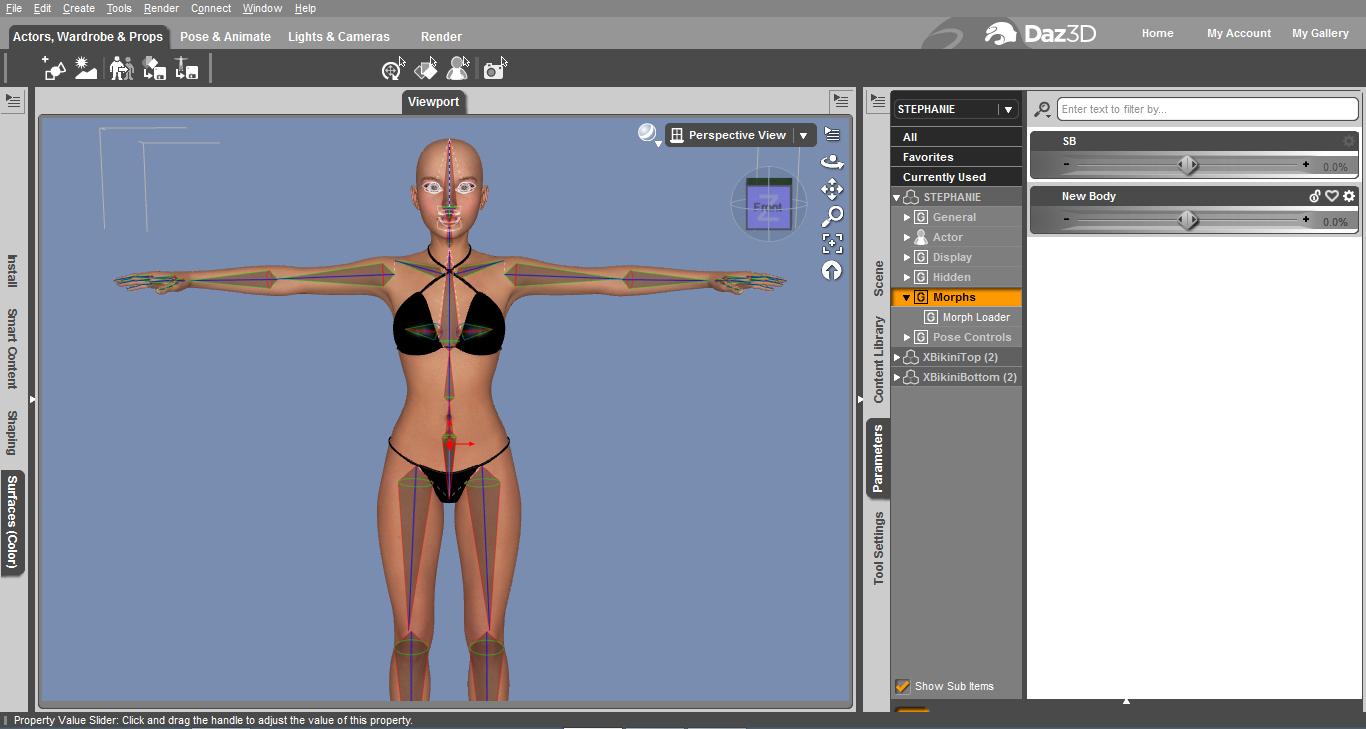

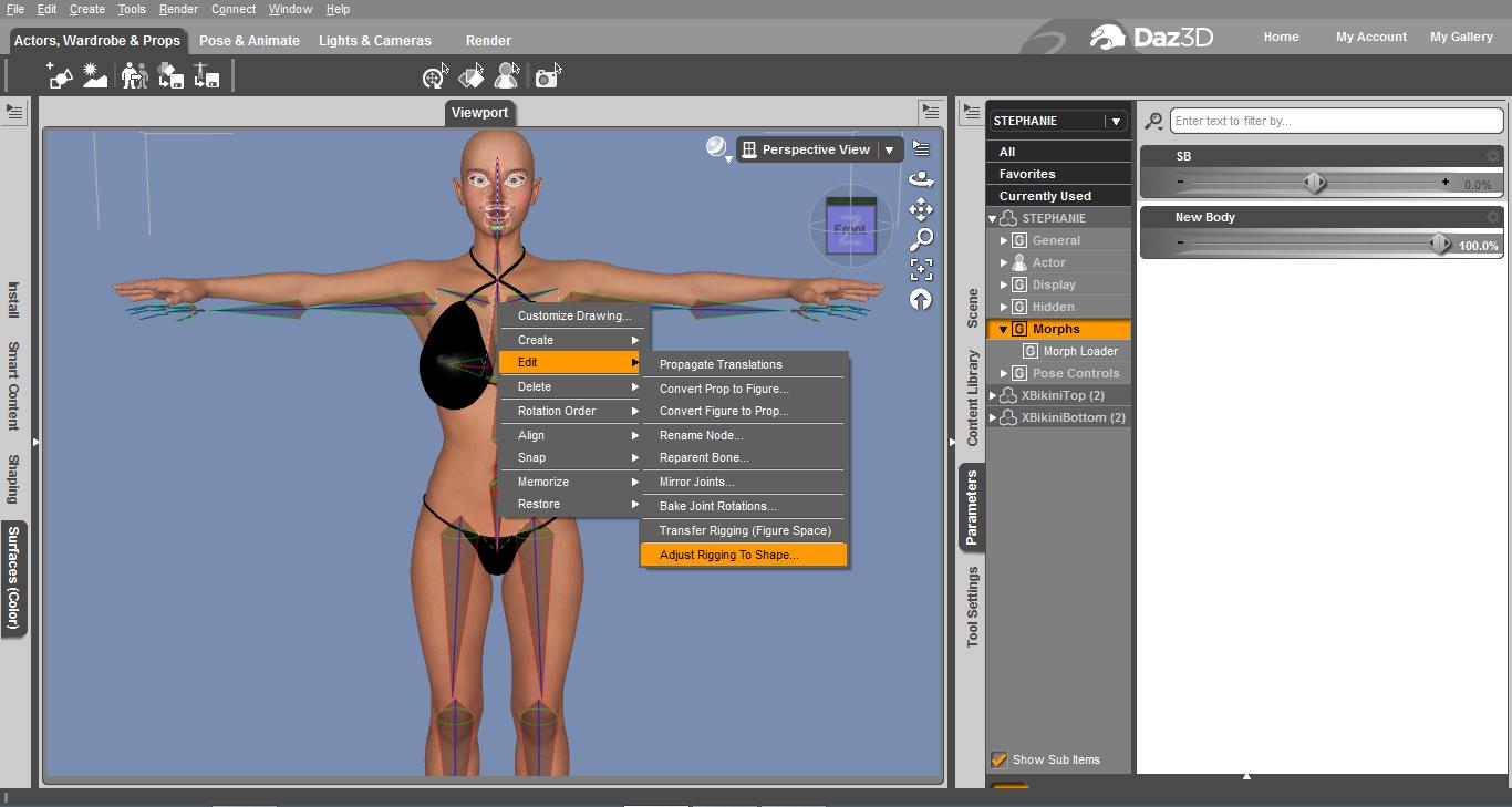

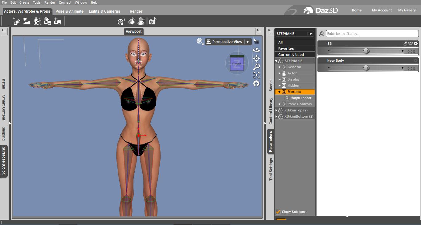

    Thank you for taking the time to help me solve this conundrum with morphs! I did all the steps as you said, but the results seems to be the same. I have provided a series of pictures of my workflow in Daz so as to see what little thing or unchecked square I marked or unmarked wrong :/
    1. The original figure with the morph slider in 0%.
    2. The figure with the morph in 100%. As you can see, the bones stick out of the figure.
    3. With the morph in 100% I adjust the rigging to the shape.
    4. In the rigging of the shape I click adjust orientation.
    5. The rig is now adjusted to the body shape with the morph slider in 100%.
    6. I select Edit Mode, and Select ERC Freeze right clicking on the body morph slider.
    7. In the ERC Freeze options I click the three squares on the bottom.
    8. This is how the figure shape looks in 100%, the bones and everything align perfectly when the slider if moved to 100%.
    9. But after the ERC freeze process, this is how the figure looks with the morph slider in 0%.
    10. A comparison of the original shape, in the right with no morphing, and at the left the figure after the ERC Freeze in the 100% slider with the morph slider in 0%.
    I dunno what I'm doing wrong! :/
