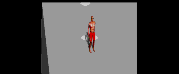

I've been struggling with a similar problem to the one discussed at this Carrara forum thread
Together with several forum posts including this thread, I studied Joe Pingleton's findings from his experiments using Brekel for mocap.
and SciFi Funk's tutorials on bringing Carnegie Mellon Mocap into carrara.
The file I'm working with is a mocap file captured to Motion Builder (I don't own or use Motion Builder, I just have these files I'm experimenting with towards settling for a mocap pipeline I can work with) and exported from there to both Fbx and Bvh formats. Both formats were making Genesis go into suicidal contortions when imported into Carrara. I noticed that Sci-Fi Funk used Daz ready mocap files from the Carnegie Mellon collection, which probably means they have already been re-targeted to work well with Daz/Carrara. I only know for sure that the bvh / fbx files I have came from Motion Builder in Maya Human IK format. I took the fbx into iClone 3DXchange5 (I got iClone recently as I'm trying to create a Carrara-iClone workflow for myself) and I was able to create a non standard character which exported fine as an iMotion that worked well with a character i iClone. So that's fine. The initial problem I had in doing that was solved by making sure I set the skeleton to a T pose at the first frame in 3DXchange before doing anything else. You would notice from the rendered sampling from that motion applied to an iclone character below that the hands are still kind of frozen at a funny angle, I believe that is because I didn't spend enough time setting up the T pose in 3DXchange, so that should be easily fixable. What this tells me is that for those who have Carrara and iClone + 3DXchange5, the iClone route might be a way to get your re-targeting done, because once you can get your fbx (didn't have as much luck with the bvh file, but more on that later) converted into iMotion files that iClone can read, theoretically you can re-export this out via 3DXchange in a re-targeted format that Carrara can read. Sadly I'm yet unable to test this theory because you can only export from 3DXchange if you have the pipeline version (which I don't have). Also note that to export certain iClone motions, you will need to pay for an export license, but that shouldn't apply if you are exporting motions you brought in yourself for re-targeting. So much for the iClone route, for anyone who's thinking of trying in that direction.
At the Carrara side of things, the bvh and fbx files from my mocap sample are not working well with Genesis. With the bvh, I tried out bvh hacker based on Sci-Fi Funk's tutorial, not to reduce the file size of the animation like he was doing, but to see if I would do some re-targeting. I tried to edit the bone structure in the bvh skeleton to better approximate the bone structure in Genesis and I renamed the bones to mirror the naming convention in Daz Genesis. It didn't make much of a difference. It is possible I just didn't use bvh hacker properly, if someone has had better success at this sort of thing, I would please like to know how. I suspect though, that the re-targeting needs to also mirror the joint rotations to be complete and I sincerely have no idea of how to do this. Joe Pingleton's work around was a bit helpful though, by applying an inverse IK modifier that tracked Genesis's hip bone to the bvh skeleton's 'hips' Genesis stopped flying all over the place but its limbs were still not behaving properly. I found out that the fbx skeleton imports well into Carrara and plays well as an individual skeleton. (See the difference between the skeleton in the capture below and the bvh applied to Genesis) I believe this skeleton can be attached to a Genesis skin but it would need time consuming weight mapping but it wont be a Genesis skeleton anyway as the naming convention would be different, so other things in Daz land- props, clothes, et al- wont work well it. So what we are looking for is how to map the motion on the fbx skeleton to the Genesis skeleton.
I suspect a work around for the fbx would be most useful going forward, judging from Brekel's post on his forum that 'FBX internally defines data the best, than the slightly archaic - 20 year old - BVH format' (paraphrased here).
Any tips / tutorials on how to achieve re-targetting for Daz / Carrara from bvh and (preferably) fbx files generated from mocap data fed through Motion Builder and outputed in Maya Human Ik format would be heaven sent. Or better still, can one dare hope that one of our ever heroic programmers in the community like Fenric and Sparrowhawk would one day give us a utility that makes this happen in a breeze? I'd be first in line to get it if that happens.
Edit: Note on the gif, got carried away, experimenting with compositing in Carrara. Hope it's till legible. The dude in red shorts is the iClone render while the Carrara screen grab with un-clothed Genesis + moving skeleton is the....well...Carrara version.
