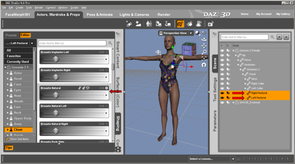

    If only I could remember what morph pac the "Natural" slider came from (For G2F). As for movement, the Pectoral on the scene tab seams to do allot for mimicking natural sway from walking, etc.
    (edit)

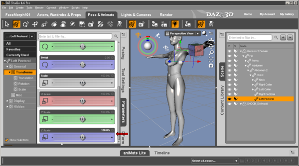

    here is at least a screen cap of the slider, and the nodes/bones in the scene tab that do the chest movement (using the parameters tab) let me look at the G2F packs I got back in march.
    "O" click the gear, open "parameter settings" and turn off "Use Limits" (also for the left and right sub-sliders as well) if you need more then the slider will allow.

    "Natural" slider came from Shape Shift (also from Zev0) if I'm not mistaken, but it can't create the hanging breast for bending down body pose. I'm sorry I forgot to tell you, I didn't create a movement, I created a still 3D images.

    Your correct, for hanging, it just makes them "Fuller" with the up-down slider that way. Hmmm.
    Z-Scale it up...!!!
    1248 x 695 - 137K

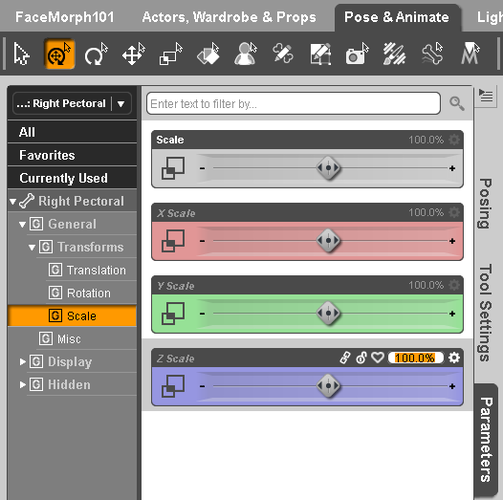

    Dear zarcondeegrissom, I already open Pose & Animate bar & I select the left pectoral but there are no X, Y, Z-scale bar on it.. What am I suppose to do to make it appear?

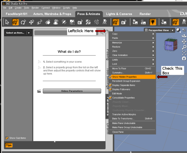

    I am so sorry about that, there "Hidden" properties. It's simple to bring them up in any the tab.
    I think this dose it for ALL hidden properties there. Including "Hidden Morph sliders" for clothing.
    900 x 733 - 59K

    I found it, but it seems that I need to set the parameter first. How to do it?
    Thnx
    edited July 2014
    slightly confused by your question. Are the sliders there with that check-mark-box checked (from my former post)?
    If it is gray, just try moving the slider, or click the "100%" text, and type in a number.
    Or is it something else?
    526 x 523 - 31K
  • tititlemottititlemot Posts: 61
    Ooo I see, they are in "Scale" bar.. I thought they are in "Translation" bar. My mistake. Ok I got it. Thanx mate
    I go one up to "Transforms" to see them all, unless it is too busy. And with Daz Studio, Just because it is gray, dose NOT imply it will not do something. Many save windows tripped me up with that.

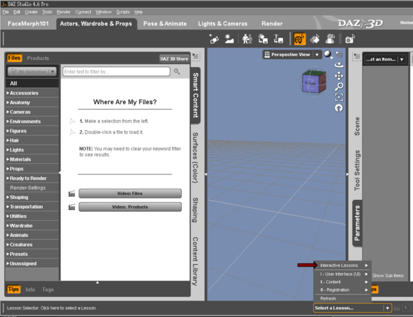

    There are some free "Interactive lessons" included in Daz Studio. If you have not done them yet, They may help allot. I didn't do them for a month or so after starting out, and wish I had done them first day.
    There are other free lessons at the store, tho some of them require stuff to be purchased for them to work. Don't just buy stuff yet, do what you can for free lessons. Then when you figure out your own style of stuff you want to work with, then look around, and ask questions.
