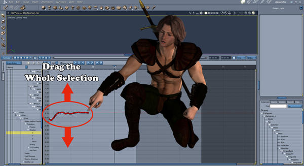

    Here's a couple of quick screen shots of a short animation of the Right Foot, and I've opened the hierarchy in the Graph Editor down to the right foot, its Motion Method, Translation, Rotation, and finally the X axis Rotation. To change the X Axis Rotation evenly across the entire animation, I would drag a select around the whole line of red boxes as shown in the second image, and then click in that selection and drag up or down before releasing the mouse button.
    Note that if you drag one of the red (or green or blue) boxes in a different time than you are currently viewing, you will not notice any change, if there is another key between it and where you are viewing. So if you need to adjust evenly, you must first drag a selection around all keys, and then click on one of the keys and drag. If it should happen where you click and release by accident, drag the selection again... you want to drag all of them at once. Dragging them right or left will dis-align them with the rest of the animation, so be careful to only go up or down.
    1679 x 914 - 883K
    1679 x 914 - 848K

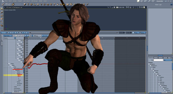

    Note the yellow highlight in the left hierarchy. In the above screenshot, I have the "X" Axis selected. The X Axis is the red one. So when X is selected, you only get the X axis rotation for that single joint - in this case, the right foot.
    So here's my workflow for that:
    Right-click the first foot to adjust in the scene and select it from the selection options. This highlights the foot in the hierarchy so I can quickly find it in the left hierarchy.
    Change the Sequencer in Graph Editor and scroll down to find the highlighted foot.
    Open the Hierarchy of the foot and keep drilling down through the "Motion Method" hierarchy to get to the rotation of the three axis, and:
    Select the axis that I need to change.
    So if you see a bunch of dotted lines, you're not looking at the right thing. You want to select the "Rotation" axis in question.
    Take a look at the hierarchy that I'm pointing at in the first of the two images above.

    Thanks. I couldn't read it very well, but this morning I tried clicking on it and it opened into a much larger picture that I can read clearly.
    Looking promising.
    Tim
    Edited to add comment.
    Wow, that made the foot correction very easy!!!

    So to increase or decrease the stride, I open the Hip's hierarchy in the Graph Editor to Motion Method: Keyframe > Transform > Position, and select "Y" to highlight it.
    To scale the whole curve evenly, drag a selection around all keys
    Look closely and you'll see a dashed line box around the selection
    Grab the top of the selection box (red arrow) and drag up or down to scale the curve, which will increase (up) or decrease (down) the distance traveled between steps.
    1679 x 914 - 1M
  • TimVukmanTimVukman Posts: 45
    Hello and thank you.
    I encountered the box around the keyframes with the dashed lines by accident in the last example you so kindly provided on the foot rotation.
    Your efforts have been much appreciated and the result is not only the solution to my problem, but more importantly you have inspired me to follow this through to the point where I am completely comfortable with the graph editor in Carrara as that investment in time will certainly help me 10 fold in Carrara animation.
    I discovered that the Poser exporter was not in my collection of Daz software and I was pleased that my platinum club membership allowed me to pick up the software at no incremental cost to me. I don't seem to see any trace of it in my export options from Daz though, so I will have to look for a tutorial or documentation. I think I will also pick up the Animate Blocks software for Poser as well. I want to be fluent in animation in Daz, Poser and Carrara and I am getting more comfortable with the blocks. I haven't started editing them yet, but I do have a need so I will continue in that direction as well.
    You have been an enormous help and I really appreciate it!
    Tim
