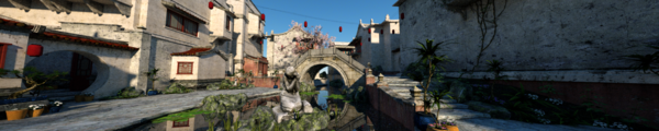

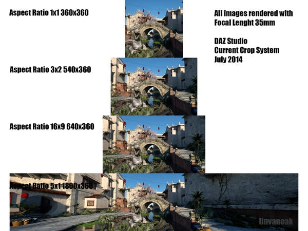

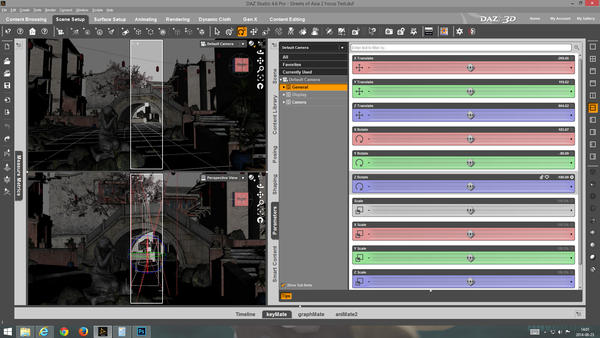

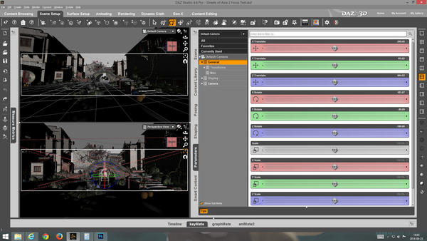

    If you want to avoid the distortion then the easiest way is to render everything 1:1 and crop when its done.
    The current situation is very time consuming for all those people who wanted to create web banners or any other images that have a lenght to height relationship larger than 2x1 like 5x1, 10x1.
    It really seems like a waste of time and money that we have to render images at 1920x1920 if we just wanted to create a banner of the size 1920x360.
    And as mentioned this is even more inconveniant for those who are working for print.
    You do really not want to render an image at
    3840 × 3840 if you just need 3840x640.
    and of course it is even worse at
    7680 × 7680 if you just need 7680x1280.
    Time is really of the essence if you are rendering at those large resolutions. You do not want to render one pixel more than you actually need.
    But in any case adding an alternative way to crop the viewport would provide a solution that does not take anything away from any other user.

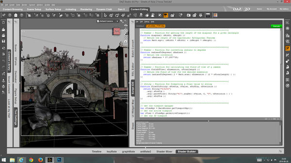

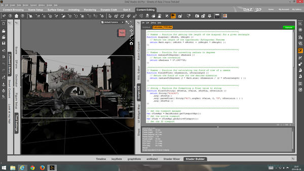

    Similar to those examples there must be some kind of calculation we can apply to figure out the corrected focal lenght value we need to
    enter in the DAZ Studio camera tab to get the field of view we actually want to see in the DAZ Studio viewport.
    Is there really noone in the DAZ Studio team that can provide that formula?

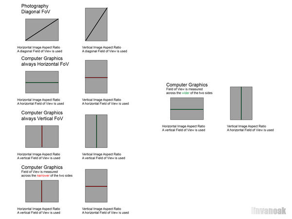

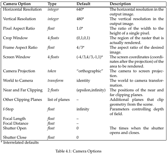

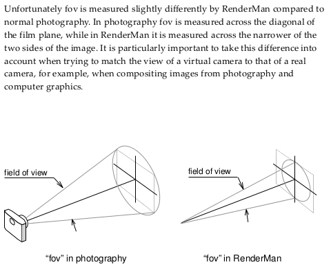

  • HoleHole Posts: 119

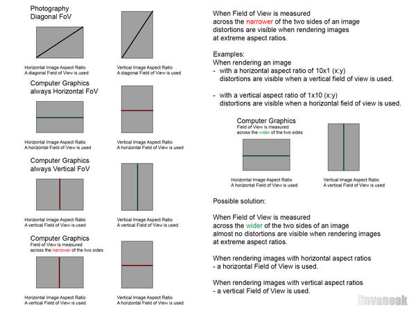

    http://www.fundza.com/rman_booklet/advanced_camera.pdf
    Field of View
    In real world photography it is convenient to change the field of view either
    by selecting a lens with a different focal length, or as in the case of a zoom
    lens, by directly altering its focal length. When setting up a virtual camera
    with RenderMan it is more convenient to accept the default focal length (1.0
    unit) and directly adjust the fov parameter using the Projection statement, for
    example,
    Projection "perspective" "fov" 40
    Unfortunately fov is measured slightly differently by RenderMan compared to
    normal photography. In photography fov is measured across the diagonal of
    the film plane, while in RenderMan it is measured across the narrower of the
    two sides of the image.
    It is particularly important to take this difference into
    account when trying to match the view of a virtual camera to that of a real
    camera, for example, when compositing images from photography and
    computer graphics.
  • linvanchenelinvanchene Posts: 1,386
    edited August 2014
    Feature Suggestion:
    Add the horizontal and vertical Field of View parameter to the DAZ Studio Camera tab
    Field of View
    example,
    computer graphics.
    Thank you so much. This is exactly the formulas and information I was looking for to better understand what is going on.
    The question now is:
    Does 3Delight in DAZ Studio also work that same way?
    If that would be the case there might be a more or less simple solution to at least be able to composite an image created in DAZ Studio to an image created in any other software or a real world camera:
    - Add the horizontal and vertical Field of View variable to the camera parameters.
    Then all we would need to be able to do is to
    - change the horizontal or vertical Field of View parameter independent of the Focal Lenght.
    It may be as simple as clicking on the Field of View and the Focal Lenght parameter in the camera tab and removing the link.
    Then what we can do is:
    Set Focal Lenght at 1 as suggested.
    Adjust the Horizontal or Vertical Field of View parameter to the value we need.
    It would be a first step and a partial solution for those 3Delight users who are trying to match their images with real world photography or other 3D software.
    It still would make sense to add other camera presets to DAZ Studio that are based on the needs of other render engines.
    Post edited by linvanchene on

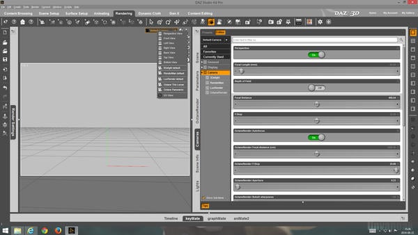

    Add Camera presets for each render engine to the viewport and the camera tab
    As I understand it the reply is saying there are two ways DS could handle aspect ratio - it could assume a frame equal to a real camera's and crop within that to give the desired proportions, or it could allow the frame to grow to accommodate the desired proportions - essentially it can treat the the virtual 35mm (or whatever) frame as a maximum or minimum. DS is being said to do the latter, the wish here is for it to do the former - I see nothing in the quoted response to indicate that a feature request to make it a user-preference which DS did would be rejected out of hand, merely a statement that having chosen the option of the two available that the ticket posters didn't want is not a bug per se.
    Edit: sorry, the forum took me to the last post isntead of the first new post and i missed that Slimer_J_Spud had already said much the same.
    This post by Richard inspired me to think more about the way plugins are integrated into DAZ Studio.
    The way I interpret this suggestion would be to add the following features to DAZ Studio.
    DAZ Studio Viewport:
    In the viewport pull down menu in addition to the "default" camera additional presets for each render engine plugin are added.
    The idea is that each render engine plugin may benefit from different ways how the OpenGL viewport is displayed.
    Guide lines like the focal planes that are not used by some plugins are hidden away in the plugin camera presets.
    Additional guide lines that are used by the specific plugin are added to the viewport.
    The viewport is cropped based on the parameters that most benefit how the specific render engine plugin operates.
    Some render engines may provide the user with several different camera presets.
    Examples:
    - For 3Delight an additional preset is added that "cheats" around the current viewport cropping and gives the user the option to render images with extreme aspect ratios like web banners without distortions.
    - For OctaneRender support for the Thin Lens and the Panoramic Camera presets can be provided.
    Currently this is not yet the case. The Panoramic Camera is only supported in the standalone version of OctaneRender.
    DAZ Studio Camera Tab
    In the DAZ Studio camera tab each render engine gets its own subtab.
    This lets the user quickly change between different camera values used by the different plugins.
    The camera values displayed depend on the render engine plugin the user has installed.
    Example:
    Users who have not installed the OctaneRender plugin do not see those values.
    This is allready the case now.
    Currently 3Delight does not yet have its own submenu. Because of that default 3Delight and OctaneRender camera values are mixed together when the top level menu "Camera" is selected.

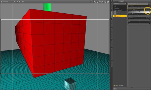

    Therefore currently it is not possible to select only those camera values that are controlled by 3Delight when a plugin like OctaneRender is selected.
    If the user opens the pulldown menu of the DAZ Studio camera tab and selects "add camera" he can choose from the same camera presets as in the viewport camera pulldownn selection.
    The "add camera" menu is not shown in the screenshot. It is accessed from the pulldown menu that opens when clicking on "Default Camera".
    As mentioned I will now not immediately submit a feature request.
    I will wait until the OctaneRender plugin v2.x is released to see how the DAZ camera system affects the plugin.
    Nevertheless if you are using 3Delight, LuxRender or want DAZ Studio to be ready when a RenderMan plugin arrives feel free to create your own feature requests now.
    The screenshot attached was manipulated in photoshop to illustrate the ideas.
    1920 x 1080 - 389K

    1) Distortions of the DAZ Studio viewport when working with 3Delight
    solution: add another crop preset to cheat to create webbanners with 3Delight
    My main argument here is that it is not time and money efficient to render the whole image and then crop in postproduction.
    We really should only render exactly those pixels we need when working with higher resolutions.
    If you want you can also consider this as a request for an advanced version of a region render that lets you choose which area of the default viewport is actually rendered.
    You can find additional details in this thread in the linked post:
    http://www.daz3d.com/forums/discussion/44176/P15/#652689

    3) Provide workarounds to calculate the proper focal lenghts by giving access to the hidden parameter Field of View
    With the help of formulas it is possible to calculate the proper values to be used in DAZ Studio.
    http://www.tawbaware.com/maxlyons/calc.htm#fov_calculator
    A photo camera uses a diagonal Field of View.
    RenderMan's Field of View is measured across the narrower of the
    I assume that the horizontal and vertical Field of View paramters are also used in DAZ Studio but hidden away.
    I suggest to give access to the Field of View parameters in the DAZ Studio camera tab.
    So why is that horizontal field of view parameter not included in the DAZ studio camera settings? :question:
    I suspect this is not a limitation of RenderMan or 3Delight but indeed a choice by DAZ.
    Speculation:
    They may have hid away the horizontal Field of View parameter in order not to confuse the more hobbyist user base of DAZ Studio.
    But if the field of view parameter is actually used in calculating the viewport it really should be possible to unhide that parameter and make it accessible for advanced users in the DAZ studio camera tab.
    http://www.daz3d.com/forums/discussion/44176/P30/#665800
    I hope this entry now summarized everything properly so it is easier to make a difference between those three issues and their possible solutions.
    I hope you can see the common idea behind each of the suggestions:
    Provide additional functionality by adding additional presets and parameters in addition to the existing ones.
    That way all users who are not interested in any advanced solutions can keep working with the default presets and parameters they allready know.

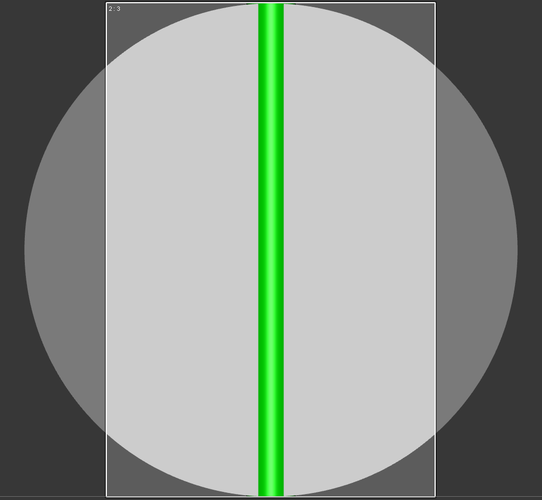

    Have you noticed that if you start off at 1:1 and then adjust the width to be less then the height you will get no distortion?
    edited August 2014
    Feature Suggestion:
    Adjust the camera reference system of the viewport 90 degree based on vertical or horizontal image orientation
    Update / Edit:
    or
    Field of View is measured across the wider of the two sides of an image
    When rendering images with horizontal aspect ratios
    - a horizontal Field of View is used.
    When rendering images with vertical aspect ratios
    - a vertical Field of View is used
    The short answer is yes.
    The long answer is I did notice that it is happening but I only started to understand why it is happening after Hole posted the link to the RenderMan documentation.
    I knew that some 3D software adjust the orientation of the reference system of the viewport cropping by 90 degree based on if the user wants to render images at horizontal or vertical orientation.
    Before Hole posted the RenderMan documentation I did not know that such an adjustment is actually included in the RenderMan specs.
    The reference system RenderMan is actually using is:
    In photography fov is measured across the diagonal of the film plane, while in RenderMan it is measured across the narrower of the
    Source: http://www.fundza.com/rman_booklet/advanced_camera.pdf
    (Again, thank you hole for providing that source of information.)
    If we are to trust what is written in that RenderMan documentation the reference system for the cropping of the viewport should change depending on the narrower side of the two sides of the image. :exclaim:
    This could mean that instead of horizontal field of view vertical field of view is used.
    What I was not able to figure out is:
    Does RenderMan also include some specs to actually adjust the complete reference system when switching from horizontal to vertical aspect ratios? :question:
    If you have a horizontal landscape image in theory the reference system could adjust so there are no distortions in the landscape image.
    If you have a vertical portrait image in theory the reference system could adjust so there are no distortions in the portrait image.
    What I can observe is in DAZ Studio no matter if I enter an aspect ratio of 2x1 or 1x2 the reference system of DAZ Studio remains the same in a way that everything is fit between the upper and the lower border of the asumed image plane.
    The result of this is:
    At vertical image orientation no distortions happen.
    At horizontal image orientation distortions are visible.
    What could actually happen to prevent the distortions is to rotate the reference system by 90 degree when the user wants to render an image in the horizontal aspect ratio.
    Then the left and right image boarders should remain constant and the cropping happens on the top and the bottom.
    In real life you make the same adjustment when you rotate your photo camera 90 degrees depending on if you want to make landscape or portrait images.
    To summarize this the main difference between DAZ Studio and other 3D software is that
    - in other 3D software there is a solution to adjust the camera system when the user switches between horizontal and vertical camera orientations.
    The question now are:
    Is there a way to adjust the complete camera system based on vertical or horizontal aspect ratios included in the RenderMan specs?
    As I tried to achieve with the previous suggestions I see the solution not in changing the way the current system works but in adding additional features that gives interested users more advanced options.
    So to stay in that way of thinking my solution would be:
    An additonal 3Delight camera preset is added that switches between horizontal and vertical field of view as reference depending on if the user wants to render images in horizontal or vertical aspect ratio. :exclaim:
    This means that all users not interested in such a solution can keep using the default DAZ camera preset that does not change the reference system by 90 degrees when the users switches from vertical image orientations to horizontal image orientations.
    Update/Edit:
    After everything that we discussed later this would mean that:
    When Field of View is measured across the wider of the two sides of an image
    almost no distortions are visible when rendering images at extreme aspect ratios.
    - a vertical Field of View is used .
    You can read about this here:
    http://www.daz3d.com/forums/discussion/44176/P45/#666832

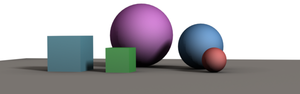

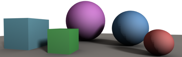

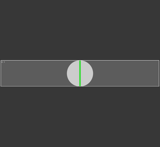

    I added another series of screenshots. This time the width is kept constant at 360 pixel.
    Aspect_Ratio_1x1_360x360_rendered_in_OCDS
    Aspect_Ratio_2x3_360x540_rendered_in_OCDS
    Aspect_Ratio_9x16_360x640_rendered_in_OCDS
    Aspect_Ratio_1x2_360x720_rendered_in_OCDS
    Aspect_Ratio_1x4_360x1440_rendered_in_OCDS
    But what you can observe is that it is not the width that remains constant.
    In fact the height of the viewport remains constant as when we were rendering images with height constant at 360 pixel.
    360 x 1440 - 3M
    360 x 720 - 1M
    360 x 640 - 1M
    360 x 540 - 1M
    360 x 360 - 759K

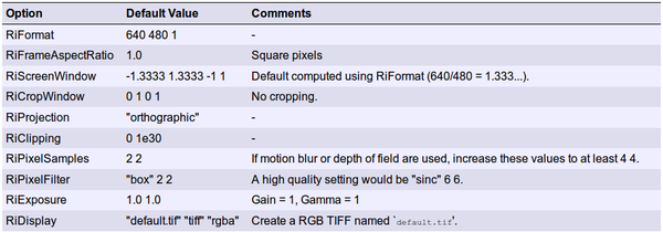

    edited August 2014
    Below the first image is the diagram from page six of the PDF file Hole linked to. You will see a diagram showing the FOV in Renderman versus a real world camera. The paragraph states "In photography fov is measured across the diagonal of the film plane, while in RenderMan it is measured across the narrower of the two sides of the image." If you look at the diagram you see that from the top to the bottom is the narrower distance so Renderman is calculating FOV based on that distance.
    The second image is from the 3Delight manual - http://www.3delight.com/en/uploads/docs/3delight/3delight_26.html - bottom of 5.1.1
    The third image is from page 20 of the RISpec 3.2 manual from here - http://renderman.pixar.com/view/rispec
    Each showing the default values for the camera. According to those tables, 640x480 is the default image resolution. So that means that FOV is being calculated based on that default value. This explains why we see distortion when the width of the image is greater than the height but not when the height is greater than the width.
    So the cameras in DAZ Studio follow Renderman specifications.
    638 x 582 - 111K
    915 x 321 - 48K
    480 x 391 - 35K
    Post edited by Mattymanx on
    edited August 2014
    First, thank you for helping in figuring this out.
    Yes but unfortunately the image only shows one case of the two possibilies.
    If you have a landscape image with horizontal field of view:
    - the narrower of the two sides is the height of the image.
    This case is shown in the manual and in the image you posted.
    If you have a portrait image with vertical field of view:
    - the narrower of the two sides is the width of the image.
    This case is not shown in the manual.
    What I took from that is:
    RenderMan has two different ways to calculate Field of View.
    RenderMan calculates field of view differently if the user selects a horizontal landscape format or a vertical portrait format.
    All I can say and also observe seems to be that Field of View seems to shift when we move from a horizontal to a vertical camera position.
    But yes I have not found a reference anywhere that put me in the position to say if now RenderMan specs offer a solution to automatically adjust for the different ways Field of View are caluculated or not.
    If it has no such functionality included then it really is true what you are saying.
    DAZ Studio, 3Delight are working as expected in the reference system of RenderMan.
    There is some small print under the pixar Table 4.1:
    * Interrelated defaults
    They could have taken any other pixel dimensions but the reason they took 640x480 was probably because that was the most frequent aspect ratios of the old 4x3 monitors that were used around 1990 when the first documentations of RenderMan were written.
    What gave me some more information how RenderMan works was reading trough another online document:
    https://renderman.pixar.com/resources/RPS_13.0/prman_technical_rendering/AppNotes/appnote.10.html
    And there they say:
    The first, and most obvious thing you might want to change is the image resolution. The default for resolution is determined by the output device.
    or
    For example, you may have heard that NTSC video “has a 4 to 3 aspect ratio
    Both quotes at least to me give the impression that the default values you quoted were mere default resolutions used at the time of the original draft of the document.
    More important seems to be that:
    In practice, one or more of those values is probably not quite what you want for your application. The procedures described below change those values from their defaults to specific desired values, and, as mentioned above, such changes sometimes change the defaults of other values as well.
    and last but not least
    Crop Windows
    Sometimes you want to generate only a small part of an image rather than render the whole thing. You could move the camera, zoom in on the section you wanted, and adjust the resolution, but that would be pretty complicated. Instead, it is very easily done with RiCropWindow. Setting a crop window does not change anything about the camera placement or viewing parameters. The only thing it does is indicate which subset of the normal output pixels you actually want rendered to the device. The crop window is specified as a fraction of the total image, rather than in pixel numbers, so that it is a resolution-independent value. The default is obviously 0.0 through 1.0 in both x and y.
    So there is even a way to crop the default viewport.
    We really should not have to render the whole image if we only need a small fraction of it.
    Maybe the real issue is that it just does not seem to pay off for DAZ to provide such solutions if I am the only one asking for them.
    I think all the puzzle pieces are now here.
    Maybe if someone else with more understanding how RenderMan works reads trough it he can piece together some working solutions.
    In any case thank you again to all those who helped in trying to figure this out. :coolsmile:

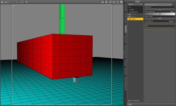

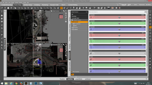

    From what Ive read and seen here, I gather that the issue of fish eye distortion is only apparent in landscape ratios. So would I be correct in thinking, the solution for now would be to tilt the camera 90 degrees and render landscape sideways? Renderman would theoretically treat it as portrait ratio.
    EDIT: I gave it a shot, and matched the camera angle with a 90 degree tilt. This of course left me with the requirement to zoom out to get it all in shot. Its the same ratio 16:5 and 5:16, I didn't touch the Focal length, which remains default value in both test renders. I think its not viable since matching the shot is near impossible. I don't have Lux or Octane to test against them.
    2000 x 625 - 569K
    2000 x 625 - 756K
    Post edited by SpyroRue on
    edited August 2014
    Thank you so much for helping in testing this.
    You post also inspired me to try.
    Step 1: 01 default orientation - original aspect ratio 1440x360
    Our goal is to render an image at an aspect ratio of 4x1.
    Focal lenght is 35mm.
    Step 2 default orientation - adjusted aspect ratio 360x1440
    To prepare for the rotation we first must adjust the aspect ratio of the image from 4x1 to 1x4.
    At this point the first problem occurs. The field of view "jumps" to fit the now vertical aspect ratio into a upper and lower image border.
    /Update / Edit:
    This jump happens because DAZ Studio at the time of writing this post kept the viewport always between an constant distance between the upper and lower image border.
    The images Mattymanx posted a few posts later show this behavior.
    Step 3: rotated 90 degrees - adjusted aspect ratio 360x1440
    If you would simply Z rotate the camera in the parameters tab by 90 degree the image would not much.
    Instead you have to switch to the perspective viewport and use the rotation tool to click the blue circle.
    Try to rotate until you hit 90 degrees. Actually quite an effort to hit exactly 90 when rotating manually because it keeps stoping at 89.7 or 90.6 degrees.
    Now you will notice that even though the image is rotated by 90 degree it does not match up at all with the original selection.
    Step 4: rotated 90 degrees - adjusted aspect ratio 360x1440 - moved camera back
    Since simply rotating the camera by 90 degrees with the viewport rotate tool is not going to match up the image you will have to adjust further.
    - Adjust rotation
    - Adjust translation
    Even though I tried it is hard to actually match up the image to the original selection.
    Can you try to render an image that way?
    Probably. Just get used to rotate your head sideways.
    Or rotate the monitor whatever you prefer.
    1920 x 1080 - 533K
    1920 x 1080 - 533K
    1920 x 1080 - 552K
    1920 x 1080 - 534K

    Update / Edit:
    How was the viewport and field of view calculated in DAZ Studio 4.6.3.52?
    The script Richard posted a few posts later shows that currently DAZ studio is calculating the viewport based on a fixed "frame" distance of 35mm.
    One side of the viewport is kept fixed at a distance in mm.
    The other side of the viewport is calculated based on that distance also in mm.
    Based on those values in the unit mm the angular field of view formula is calculated.
    Fov = 2 x arctan ( d / (2xf))
    The formula was posted by Takeo Kensei a few posts laters.
    Nevertheless we did not know that at the time of writing this original post!

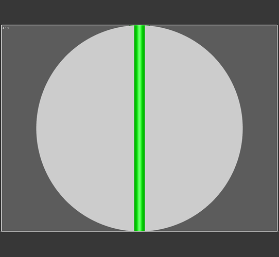

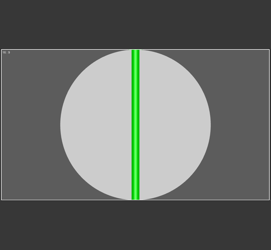

    Mattymanx said:
    linvanchene,
    FOV is being calculated based on the default value of 4:3. Because that is the default value Renderman will always adjust FOV as if the height was the lesser distance because it is in the default value. Even if the width is less then the height, FOV is still being calculated based on the default value of which the height is less then the width. This is constant within the software, it does not change.
    I still do not understand how you come to that conclusion.
    In the linked Renderman Manual that you quoted yourself it says:
    Statement A: Field of view in RenderMan is measured across the narrower of the two sides of the image.
    You say:
    Statement B: FOV is being calculated based on the default value of 4:3.
    Under which assumption does statement B make any sense if you assume that statement A is correct.
    Statment A says that Field of View is measured based on the narrower of the two sides of the image.
    I still do not understand what unit the default value of 4:3 is even supposed to have?
    4:3 of what? mm? pixel?

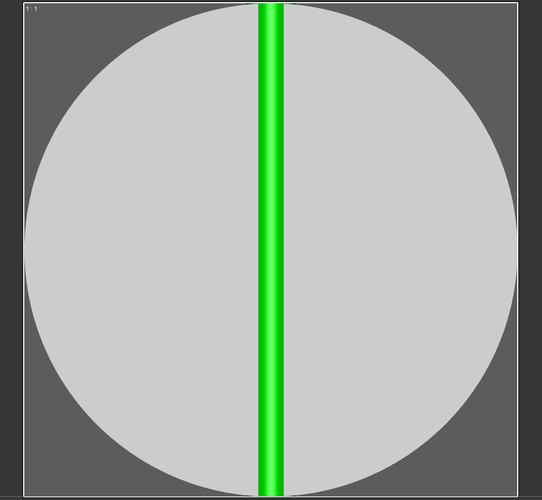

    I attached a screenshot that shows how the narrower side of the image results in using both vertical and horizontal field of view depending on the orientation of the image.
    1920 x 1080 - 187K
    See this chart again from the RiSpec 3.2 manual
    638 x 582 - 111K
    edited August 2014
    You did not answer my question.
    Posting that chart is about the same as making a snapshot of your current DAZ studio render settings and then posting it here.
    That does not explain how Field of View is calculated.
    It just shows what current settings your are using.
    It clearly says on the table Camera Options.
    What you have posted are possible options to use and not default values on which field of view is always calculated.
    The main purpose of that chart is to show the users what kind of values they can enter.
    I explained that allready a few post back when you originaly posted that chart for the first time.
    You could enter any other values in the fields marked with * and all the other values would adjust.
    I still do not understand what unit the default value of 4:3 is even supposed to have? 4:3 of what? mm? pixel? Please answer that question I allready asked in my previous post.

    Renderman users NTSC (4:3 ratio) as its default base. Meaning that the distance between the top and bottom of the frame being the shorter distance is how it will judge FOV. Rendermand will never judge FOV based on the left and right side of the frame even if its the shorter distance.
    Interrelated means that the default values are connected to one another.

    The document Hole posted and which we quoted some time may be true for RenderMan:

    Summary:
    It seems in RenderMan related engines there are actually three different ways used to measure field of view:
    - horizontal field of view
    - vertical field of view
    - Field of View is measured across the narrower of the two sides of the image.
    This means either horizontal or vertical field of view is used based on the aspect ratio of the image.
    Earlier it was suggested to contact Pixar to figure this out.
    Nevertheless I start to believe that this is a mute point.
    Even if they suggest to calculate field of view a certain way it seems it is up to each license taker to implement the system how it fits best their specific software.
    So the only people that actually should know how their camera system works is the DAZ development team.
    Is 3Delight for DAZ Studio using vertical or horizontal field of view or both depending on the aspect ratio? :question:
    Update / Edit:
    I have now sent a support ticket to ask them.
    I added some duplicate quotes and information so the support staff can find the relevant information in this post.
    I added a graphic that shows all the possible ways of how to calculate field of view.
    On the graphic you can also see a forth way to calculate field of view.
    Field of View is measured across the wider of the two sides of an image!
    2000 x 1500 - 287K

    For everything I write now I assume two things.
    1) DAZ Studio 3Delight is always using a vertical field of view.
    2) OctaneRender standalone is always using a horizontal field of view.
    If any of those two statements is not true then everything I write now will not be true either.
    But if both of those statements are true then everything I write now could also be true.
    What I was able to observe was:
    When Field of View is measured across the narrower of the two sides of an image distortions are visible when rendering images at extreme aspect ratios.
    Theoretical examples:
    When rendering an image
    - with a horizontal aspect ratio of 10x1 (x:y)
    distortions are visible when a vertical field of view is used.
    - with a vertical aspect ratio of 1x10 (x:y)
    distortions are visible when a horizontal field of view is used.
    Practical examples:
    DAZ Studio 3Delight seems to use a vertical field of view.
    When rendering images at extreme horizontal aspect ratios of 10x1 distortions are visible
    Nevertheless when rendering images at extreme vertical aspect ratios of 1x10 no distortions are visible.
    OctaneRender standalone seems to use a horizontal field of view.
    When rendering images at extreme horizontal aspect ratios of 1x10 no distortions are visible.
    Nevertheless when rendering images at extreme vertical aspect ratios of 10x1 distortions are visible.
    Possible solution: :question:
    - a vertical Field of View is used.
    At the moment I am just interested if in theory if we want to render images with the least amount of distortion we should always measure field of view across the wider of the two sides of the image?
    Do you know any 3D software or render engines that are allready doing it that way?
    Or did I asume quite a lot of things and this may not work that way?

    Btw:
    To make it simple:
    red bar means there are distortions
    green bar means there are no distortions
    2000 x 1500 - 473K
    edited August 2014
    Since images can say more then words I just wanted to help clairify how Renderman will always measure FOV in a scene regardless of image dimentions. This is a constant that never changes.
    In each image, the green line is the distance Renderman is using to measure your FOV
    1004 x 926 - 18K
    1004 x 926 - 7K
    1004 x 926 - 10K
    1004 x 926 - 15K
    1004 x 926 - 12K

    I am not quite sure yet how exactly but it seems that in DAZ studio currently some variable is always kept fixed and that may be one of the reasons why the green line or any scene object that is fit to match the upper and lower viewport border always is locked between the top and the bottom of the aspect ratio we select in DAZ Studio.
    OctaneRender is using horizontal field of view.
    There the image is kept at a constant distance between the left and right side of the viewport.
    The script Richard posted seems to hint at that the way DAZ studio calculates the viewport may be updated in one of the next studio releases based on the script code:

    How is Field of View calculated in Photography?
    I leave this calculation here so those of you interested in using the formula manual have an example.
    It can get tricky very quickly.
    You will find the math behind the calculations on those pages if you are interested in doing the math yourself instead of using a script.
    Angle of view:

    All the pictures Mattymanx posted and all the testing I did seemed to point in the direction that the current version DAZ Studio 4.6.5.32 is still using vertical field of view.
    Speculation:
    BUT Support refered to the script that includes alternative calculations based on the next DAZ Studio update 4.6.4.70.
    Because of that I assume that the answer of the head developer was based on the version of DAZ Studio that is currently in beta.
    In that way the code lines we spotted in the script could be interpreted in a way that the future version of DAZ Studio will use horizontal field of view.
    If that is the case I would welcome that update because it will bring DAZ studio closer to the way other software are calculating field of view.
    This could also mean that the distortions user noticed when rendering images at extreme horizontal aspect ratios may be gone.
    We will see how it works as soon as DAZ Studio 4.6.4.70 or newer is released.
    @ Script:
    I don't know exactly what they are going to amount to, but if you look at the (carefully redacted) changelogs for the private beta, at http://docs.daz3d.com/doku.php/public/software/dazstudio/4/change_log , you will see there are lots of entries reading "Work on rendering improvements [internal]" - that may well indicate that something is going to change in respect to this issue (there's also an interesting entry under 4.6.4.69 "Added render dimension override properties to DzBasicCamera" though again, I'm not certain what we can safely read into that).
    In the meantime there is a script in the samples for calculating the current FoV, which should help to make things more concrete http://docs.daz3d.com/doku.php/public/software/dazstudio/4/referenceguide/scripting/api_reference/samples/rendering/calculate_fov/start (I thought there had been a script earlier in the thread, but was thinking it was one of Casual's).
    Thank you A LOT to the persons who created the script!
    And Richard again, thank you A LOT for posting it.
    I would not have found it and more importantly not even thought to actually look for a script.
    This will help tremendously when trying to render out images in DAZ Studio that have to match the viewport of other software.
    Quick guide to the script Calculate_FOV.dsa:
    - download the .dsa file
    - place the script file Calculate_FOV.dsa in your runtime script folder
    example:
    My DAZ 3D Library\Scripts\Calculate FOV
    - open DAZ Studio
    - go to windows / panes (tabs) / Script IDE
    leave the Script IDE tab open or attach it on the left or right side of your viewport
    - In the Content Library tab browse to where you placed the script
    example:
    - click on Calculate_FOV.dsa
    - browse to your open Script IDE tab
    - in the script IDE tab select execute
    Note:
    Just clicking on the Calculate_FOV.dsa will not automatically open the script IDE tab.
    Update / Edit:
    - attached two screenshots
    Focal lenght 35mm
    one rendered at an aspect ratio of 1x1 the other at an aspect ratio of 16x9
    - removed some observations on the current system
    I guess we will have to wait and see how it looks like in 4.6.4.70.
    No point in worrying about a system that seems to get changed with the next update.
    :coolsmile:
    1920 x 1080 - 579K
    1920 x 1080 - 618K
