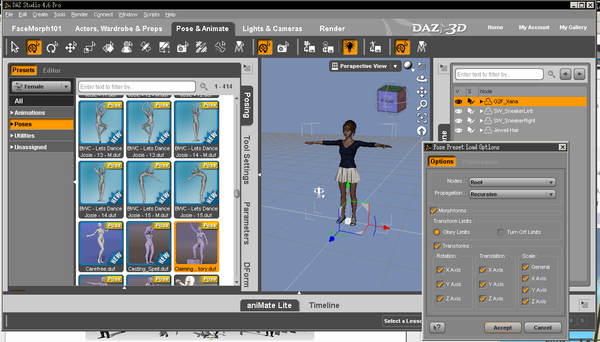

    EDITED to answer my own question I think, I just found a comment indicating this is for DAZ Studio format (duf I assume) poses, but not for pz2 poses.
    That could be. I just tried a random one (screen-cap atached), and the box appeared. It is a "DUF" pose tho.
    1256 x 715 - 200K

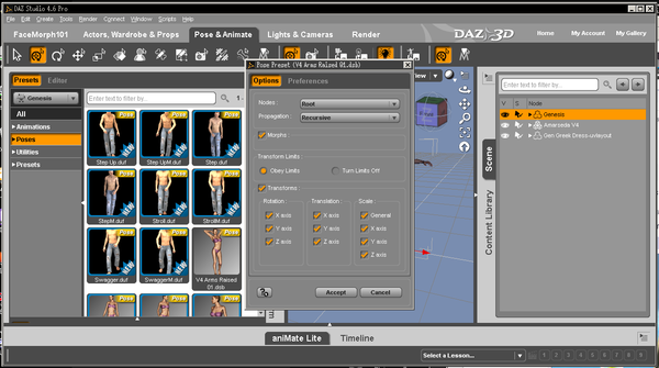

    edited July 2014
    Discovered something called a "DSB" pose for V4, with Genesis(1) loaded. "Ctrl" worked that time as well.

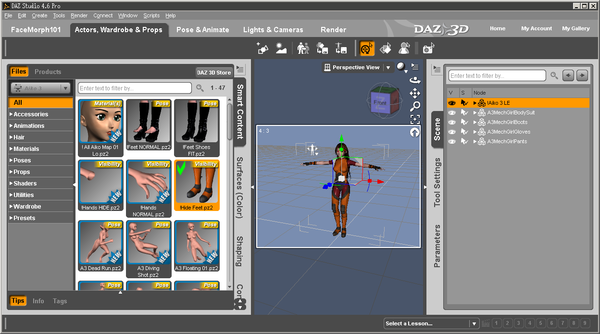

    I just confirmed that it is at least with some PZ2 poses. I don't have many, tho with the "Hide feet" one, it just loaded the pose preset with no window asking for what to do.
    Same with that "Deep Run", "A3 Diving Shot", and the "Floating 01" poses that came with that "Anime Star Fighter" pack.
