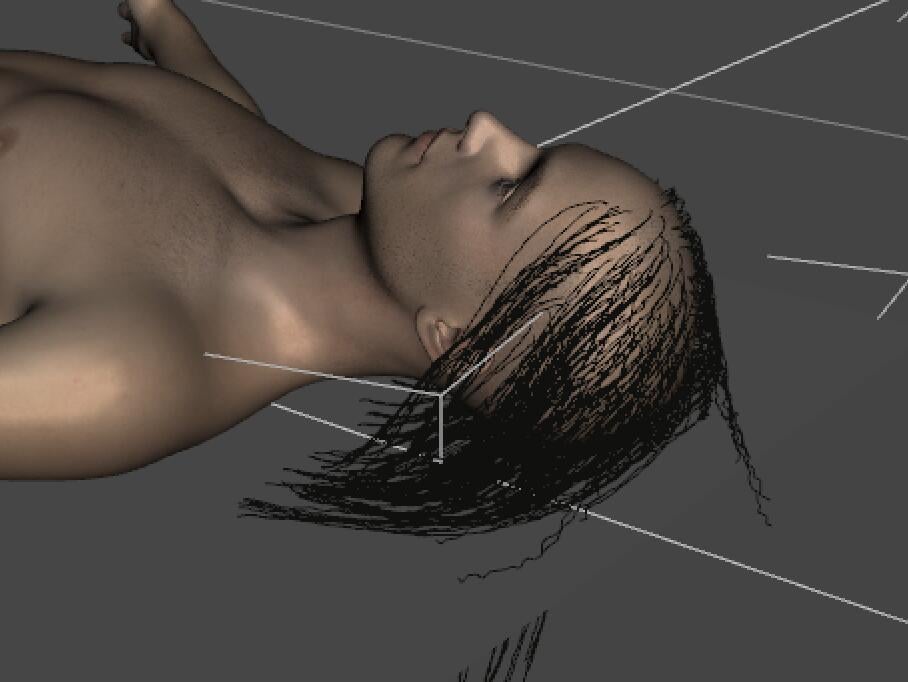

How can dforce hair not penetrate the floor?
smileyi creat a plane and division is 200 , but DFhair still  penetrate the floor.
440 x 277 - 13K
    moved to the commons as it is not an offer of a freebie

    This is what happens after the simulation The hair fell straight down

  • Guys,I found an interesting thing, it seems that the two sides of the hair are blocked, but the middle of the hair is through
    908 x 682 - 43K
    807 x 792 - 54K
    Is is going through the plane before simulation?

    no, didnt touch.

  • Basically, for the hair to fall on the floor, you need to raise it above the floor before running the simulation.  In this example, I raised the hair above the floor and then turned off the option of running the sim from the intial pose.
    400 x 520 - 131K
    Your image showing half the hair on the plane and the other half below the plane is what you'll get by running dForce on Current Frame while you have your model in it's final pose.
    As I mentioned up on my first post up top .. you need to run the simulation as an animation .. on your settings you have it set at Current Frame .. the hair isn't going to automagically jump above the plane before settling if you do Current Frame .. You need to set "Frames To Simulate" to "Animation Range" and then you need to do run an animation with your model, on the first frame, floating 2 foot above the plane (or when ALL the hair is above the plane) and then, on the final frame, the model is lying flat on the plane in your final pose. It will then run the simulation over the number of frames you have in your animation (I suggest 30) .. each frame lowering the model bit by bit towards the plane and having the hair settle naturally.
    I don't want to spam YouTube video links here - but take a look on my YouTube channel in my Sig - you'll find a video showing what I mean by using dForce on a skirt over a 30 frame animation and a ground plane .. the same principle applies to hair.

    but if you check second pocetur so many hair go through the plane ,and final render is same

    Hmm. Something is not right with this image at all. Is this strand based hair?

    i think your video Solved my problem!
    thank you very much!
