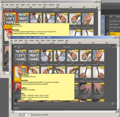

    And here are two more screenshots of the same virtual Content Library category, showing the actual paths of two of the content items (circled in red). You can see their runtimes are actually in two separate file paths, even though I chose to have them all displayed together in the same folder visually.

    Oh right. I see what you mean now. That is a really helpful way of looking at it! I didn't know you create your own custom categories. Cool!
