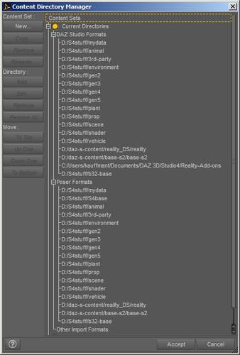

    Actually - as near as I can tell - DAZ Studio will by default save files to the FIRST DAZ Studio content directory you have defined in your list of directories. And this just happens to be the first in the default list. Go to Edit -> Preferences, select the Content Library tab and then the Content Directory Manager button at the bottom; click on the '+' by DAZ Studio Formats to expand the list.
    Then click on the DAZ Studio Formats entry - should bring up an 'add' option on the left. Click on 'add' and browse to the directory you want to save things in. Click on 'Move to Top' to make it the first in the list.
    Repeat for the Poser Formats entry (you'll want it in both) and feel free to delete the entry you don't want used.
    I've attached my directory list - which is real overkill, dating from pre-DIM configuration - and you can see I don't have the entry for the default in my Documents folder. I just checked, I never deleted the default directory and it is empty; never had anything saved to it. Also, I have everything on a non-system internal drive (D: on Windows -not sure of what it would look like on a Mac).
    468 x 693 - 86K
