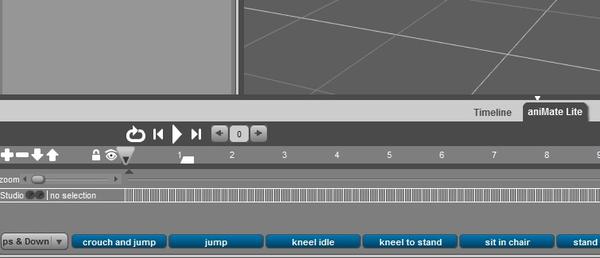

  • FishtalesFishtales Posts: 6,233
    It is Animate Lite I have so there must be a difference in the animation panel between it and Animate2.
    You can see it in this screen shot, it looks like a 'ladder' running along underneath the timeline.
