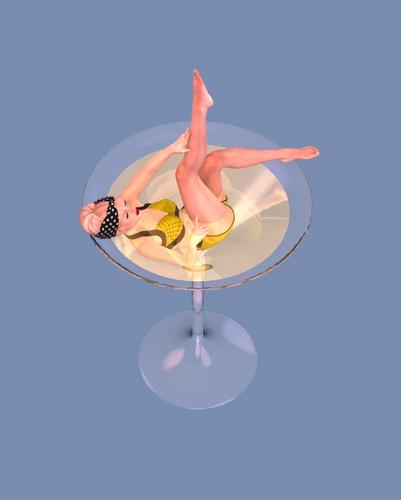

Thanks guys. I have found and am playing with the refraction settings. There are several surfaces, eg glass inner, glass inner dsmartini2 outer, glass outer, glass outer dsmartini2 outer, plus same two for the liquid. I have set all to zero to start with (but I'll continue playing), thank you so much for your advice. I haven't tried the max ray trace settings yet, though, that's next. This is the result at all refraction settings to zero using standard lighting etc:
