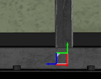

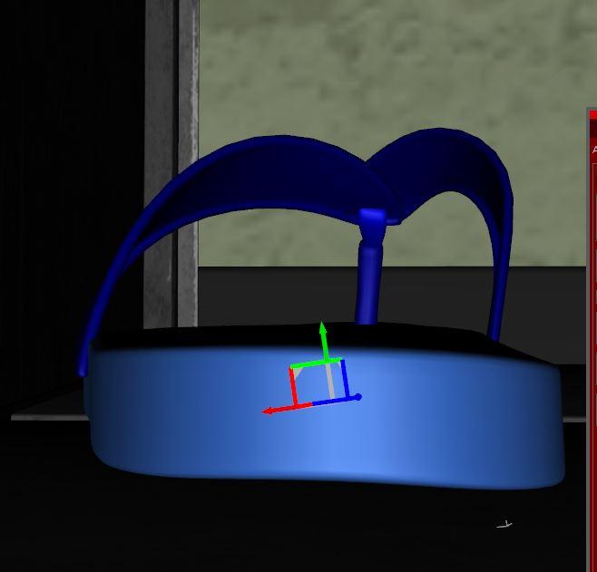

Hi,
I have here this shoe and this should be my zero pose, but the translation/rotation tool is not uhm... flat?
But the Joint editor show the nodes in a 90°, looking flat :(
I dont want that the node is skew, how can I set the flat position to be correct like the translation tool at a correct prop:
I hope you understand me :)

  • lilweeplilweep Posts: 2,873
    i need to know this too.  I always end up parenting props to nulls or grouping them so i can have correct orientation.

  • What do the Orientation values say in Tool Settings, with the Joint Editor active. I think the crosshairs for moving the points are always oriented to the world.

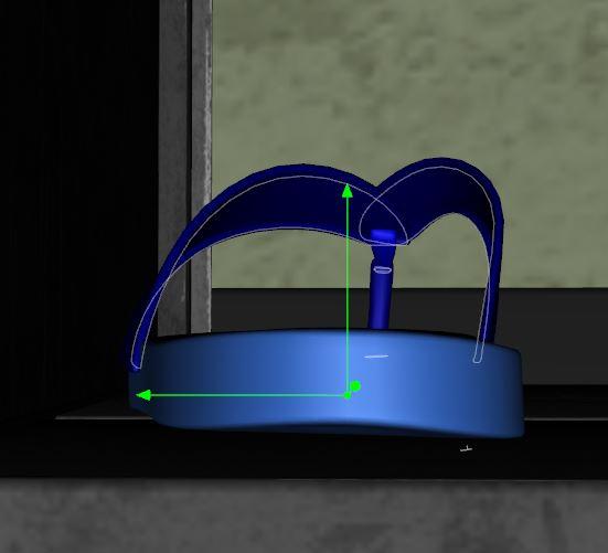

    Well, I got now a new product here (I deleted all the polygons around, so i have a single useable prop of this thing, to look in the mouth (spatula; from google translate) :D
    Now I wanna make it flat and then the Node on the middle, how to do it?
    I entered the Z rotation which I use on the prop, is that correct?
    When I now try to move the green arrows, then does the prop fly away (sometimes it fly away, sometimes not... O_o; for diff props)
    Edit: ah okay, it only moves, when the object is not on zero values translated/rotated.
    Edit: I think I made it... its not the Tool arrows who moves, its the little white corners who moves to show if the placement is correct.
    I used now this:
    I can now set the value to memorize the pose also for my figure, but then is the "zero" value -81, is there a way to say its not -81 as default, its 0?
    if I would set 0 as default it would jump back, when I set -81 as default it would work, but, I always wanted to know is it possible to replace the value with 0 and Keep in that position? So we have a new 0 pose?

  • You could just position it flat, export as OBJ, reimport. That will bake any transforms, in effect.
