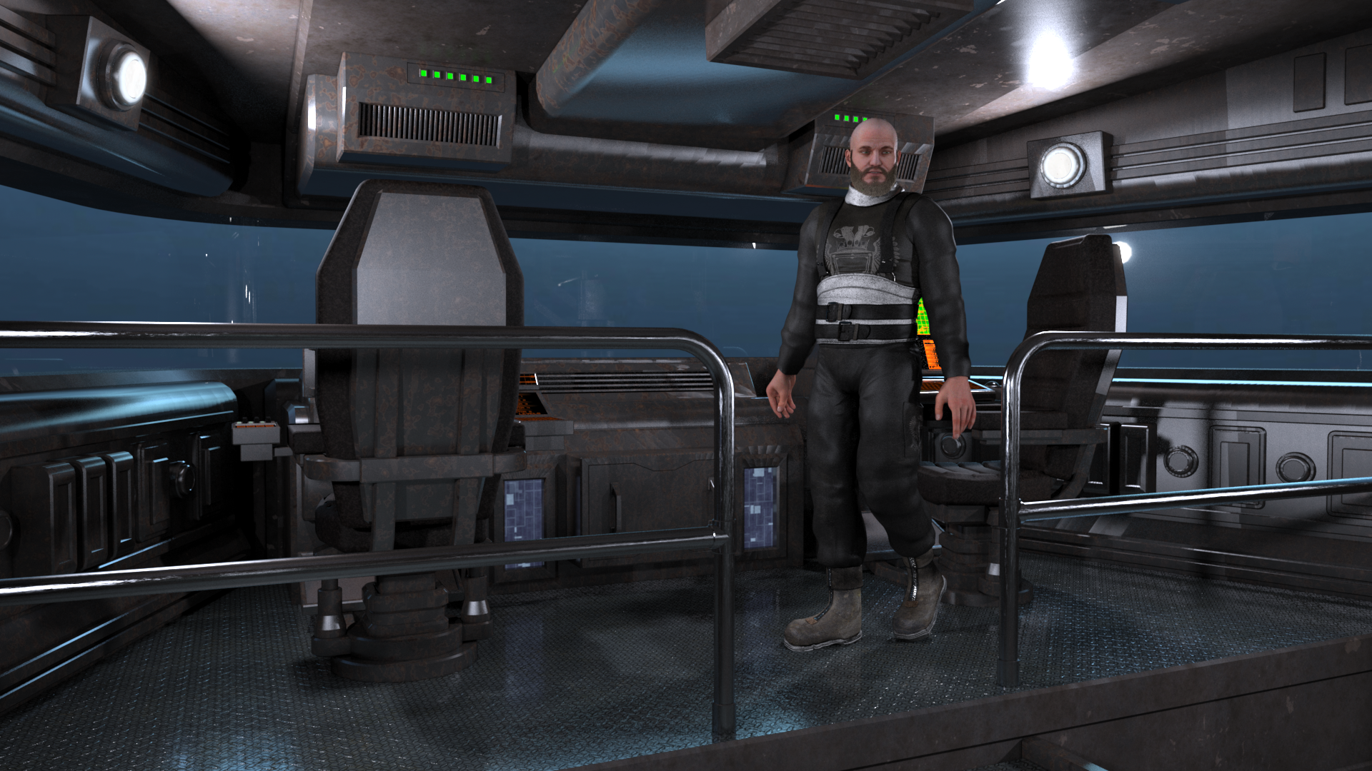

    Rendering metals properly in 3DL is a matter of choosing the right shader for the job. The dz default shader is highly limited, the reflections are always "perfect", as in 100% sharp. That works well for mirrors but for things like brushed metal etc, not so much. And you have to estimate the color of the reflections;) The OmUberSurface adds the option to blur the reflection, and has an anisotropy control and two specular lobes that will go a long way. And there is this: https://www.daz3d.com. It's on my wishlist so haven't tried it, but it's an actual shader and not just another dz default preset. Adds some nice features for sure.
    Or you can go all the way and enter the world of scripted pathtracing with wowie's Awe Shading kit, free for personal and commercial use. Direct DL link: https://drive.google.com/file/d/1i3P5yVxiS4wZzhdZu6FeLNuiNuIPOAVe/view?usp=sharing
    Some metal surfaces using aweSurface:
    Btw...the only converter I've tested is the free script from the freebies forums. For reasons unknown it inserts the diffuse map in reflection color. This means the diffuse map is simply wrapped around the reflective object, think old school faked reflections. This also means you will have no raytraced reflections at all. If this is the case with your converter, simply remove the maps from reflection color. To further expand on the matter, if you use a  map  in reflection color for fake reflections you should atleast use a dedicated reflection map, not the diffusemap LOL.
