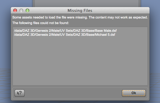

1. I get this when I try and load the default female
2. I get this with the default male
Daz 4.6.3.22
1071 x 158 - 35K
458 x 301 - 29K
519 x 334 - 42K

I can't reproduce this at all. I can load Cardinal and Raven for both G2F and G2M as well as the mats.
Did you install the Raven with DIM also, and is it in the same location as the Genesis 2 figures?
How I have M5's UV on G2F in the first place I have no idea, but it's there.
Yes, that's it.
I did install with DIM.
When I view files from DIM, G2MStarter is Users\shared, as is G2FStarter, and Raven installed to Users\me, but I can load all my G2F chars( Aiko, Giselle, etc) without issue.
Can I just add the Users\shared path in DAZ Content Directory Manager( i currently only have Users\me pointed too) or would it be better to just move the files manually.
Regards
Eric
Yes, any path where content exists needs to be added to Daz Studio's Content Manager under both Daz Studio format and Poser format.
This will work just fine... Both paths added properly.
