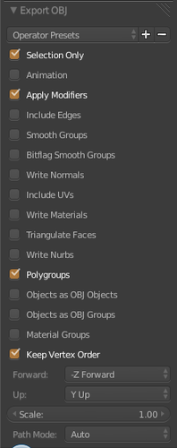

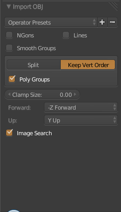

    Here's a screen of the import/export settings for morphs, just in case that's your goal. If it is, you'll also want to be sure to keep the polycount the same. You don't want to add or remove verts/faces/edges otherwise you'll get a mismatch in geometry. In sculpt mode, leave dynamic topo off.
    I don't paint in Blender, but I'm assuming you'd include Write Normals, Include UVs, Write Materials, and Material Groups in the export options.
    Sometimes I'll hit S and 10 in Blender to scale up the figure, since they tend to load in pretty tiny. If you do this, be sure to change the export scale to 0.10 to get it back to normal size.
