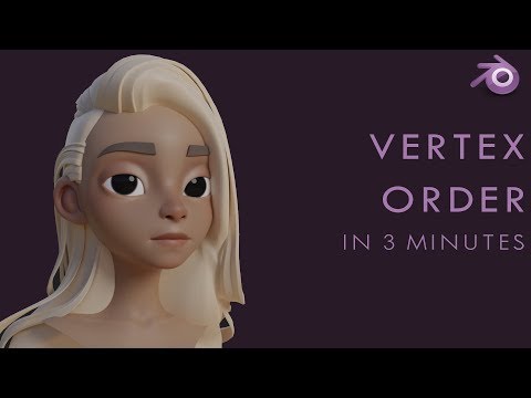

    It won't work because DAZ and Zbrush use differente subdivision algorythms. DAZ uses Catmark while Zbrush uses Catmul-Clark. When you use the "reconstruct subdivision" feature in ZBrush you are breaking the vertex order of the model. That's the reason why it explodes when loading it back to DAZ.
    One solution is to use Blender's addon "Transfer Vertex Order":
    The addon restores the correct vertex order to your mesh so you can now load it back successfuly as a morph in DAZ.
    (Maybe Maya has something similar but I don't know as I have never used Maya.)

    OH COOL!  Thank you for the info!  It's really nice to know the technical "WHY" behind why it's doing what it's doing, even if it doesn't change the end result.  I'm so hesitant to adding a 4th program to my already blown-out pipeline, but if this works it's worth looking into.  I'll take a peek and see if I can figure it out.
