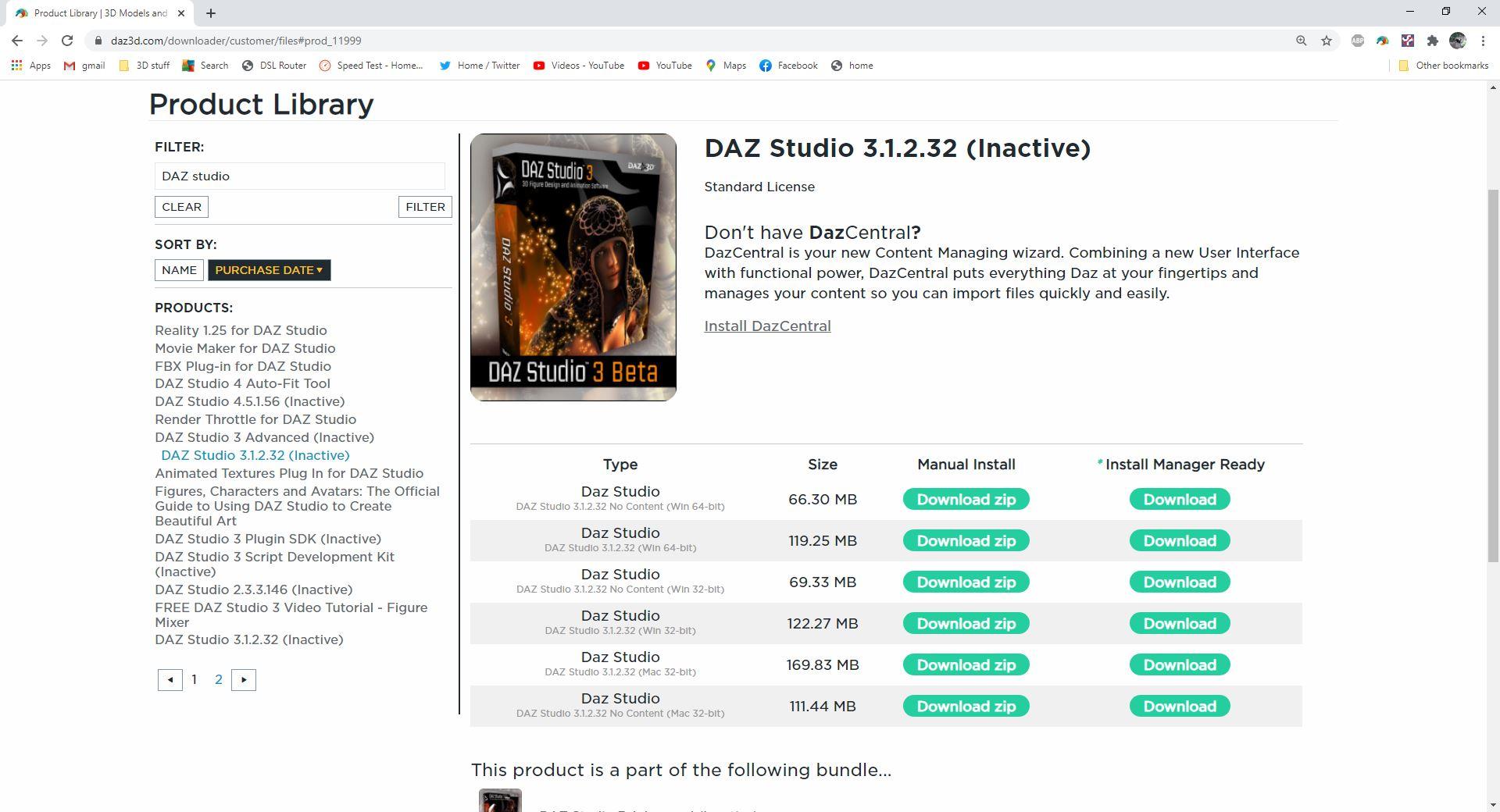

  • richardandtracyrichardandtracy Posts: 8,208
    edited September 2020
    The download button has disappeared from the product page. The only thing available to download is the base content bundle in Win & Mac formats. Oh and lots of lovely advert blurb about 'Daz Central' to ignore. See for yourself:

  • WendyLuvsCatzWendyLuvsCatz Posts: 41,744
    I have several including this one
    maybe you never bought advanced
    I did for $1 in a sale
    1920 x 1040 - 218K
    You're right, I never bought the 'advanced' version. Could be the difference. Maybe mine is the other DS3.1.2.32 listed just above the page numbers on the left of your list.
    Hang on a sec. The 'box' image on yours says 'Beta' which mine doesn't. Odd.
