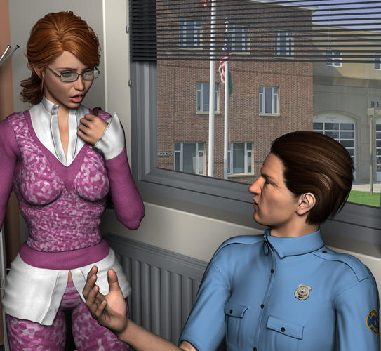

    Honestly, my preference when doing something like this, even with windows or glass, is to render against a blank background using a .png output rather than JPG, which gives a transparent background. Then I will use PS to paste in a nice sky or other background from a place like CGTextures. Usually if the glass is present, you will see the effect through the glass even this way, if you layer the background UNDER the glass layer.
    EDIT: I have attached an example. The shot through the window is just a picture of a fire house I got off of Google Images (using the "non-commercial re-use with modification button), and you can see it is not at full brightness because there is a non-transparent window in the way.

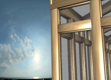

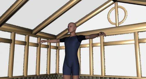

  • FirstBastionFirstBastion Posts: 8,090
    Loaded into DS4.6 and using a physical skydome, the glass worked as expected, but while placing an image of the sky as a backdrop in DS, the glass showed up white, then tried to adjust settings for both reflection and refraction the sky backdrop was visible through the glass if refraction strength was lowered to 0 or the refraction index was increased above 1.3 or so but it distorts the backdrop image. Using a physical skydome or picture plane are both viable solutions.
    500 x 270 - 101K
    372 x 269 - 29K
    500 x 270 - 103K
  • AndySAndyS Posts: 1,449
    Yes,
    somehow that behaviour is strange.
    But on the other hand:
    What distance for refraction should the render engine estimate between your glass plane and the backdrop image?
    So a normal window causes no remarkable refraction I found two working possibilities.
    1. Set refaction strength to 0 or
    2. Set the refraction color to black.
    Both worked to get the backdrop image visible through the glass plane.
