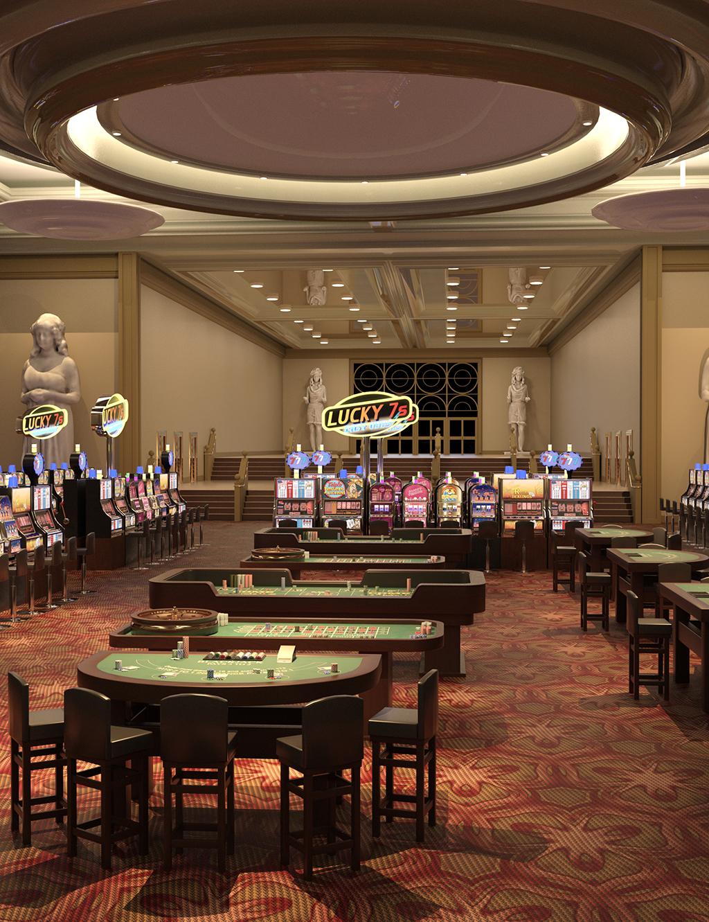

    Here is a render of the Promo Scene. This is clearly better,, out of the box, than my previous render. I reduced the size for the forum post. It makes a big difference if I start with the right version.
    1024 x 1331 - 1M
    Post edited by Chohole on
  • If you load the content into an empty scene, rather than opening one of the sample scenes, then you will get the default render setting - which include tone mapping set for a bright day outdoors. I think the first render would have been much improved by something like upping the ISO value in Render settings (unlike a real camera it doesn't matter which exposure cotnrol you adjust as there are no trade-offs)
  • That is obviously an iRay render. The shadows and the reflections just scream PBR.

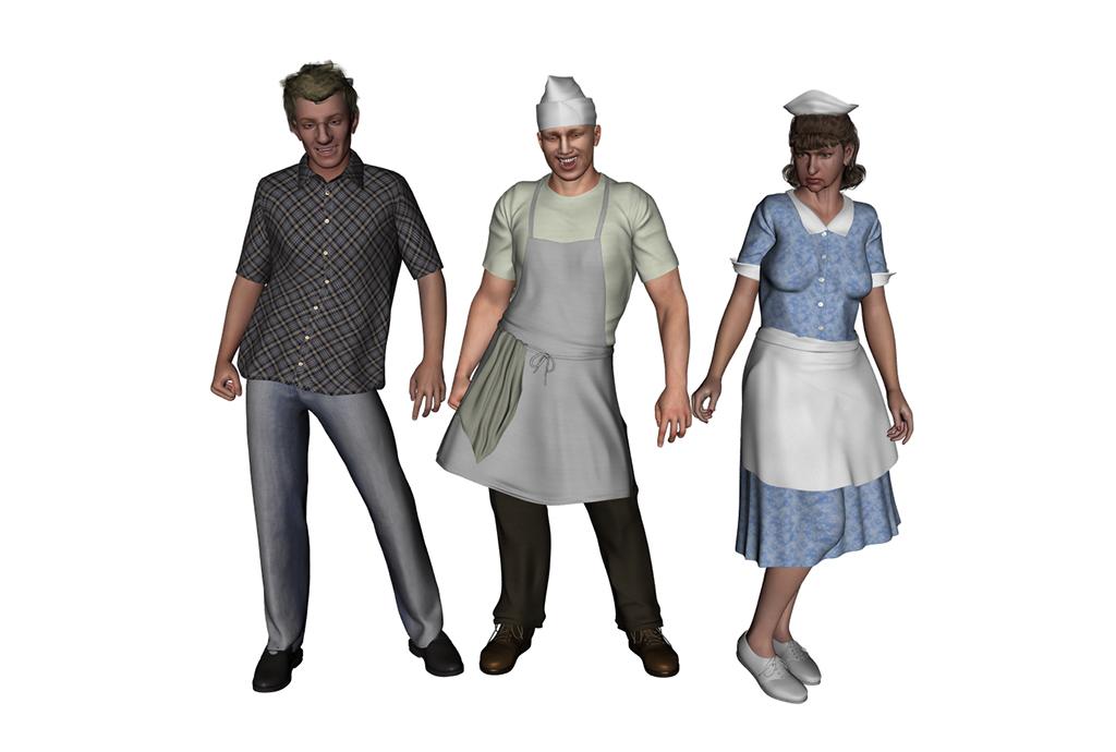

    I have much to learn. Some of my work will be much simpler. Many of my Marlin Fingle characters were created from Genesis characters. They use 3delight textures. In this image, Marlin is my creation. The short order cook is a Michael 5 character "out of the box." Bitti Botti was created by me
    1024 x 690 - 199K
  • I have much to learn. Some of my work will be much simpler. Many of my Marlin Fingle characters were created from Genesis characters. They use 3delight textures. In this image, Marlin is my creation. The short order cook is a Michael 5 character "out of the box." Bitti Botti was created by me
    3Delight materials using the standard shaders should convert to Iray automatically. Glass and metals may need tweaking for best results but most things should be at least tolerable. Items that use true custom shaders (literal RSL code or Shader Mixer) will need to be redone.

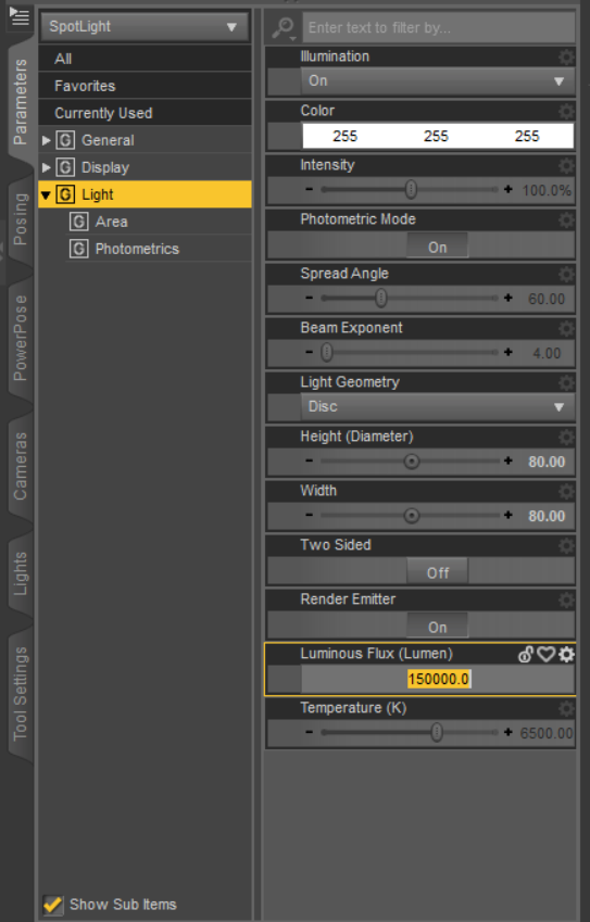

    I'm not an expert like some here but I'll add my advice FWIW. I often get away with an HDRi and a single spotlight in IRay. This is difficult to manage when your scene is indoors but there are useful things called IRay Section Planes which, carefully placed, can let the light in. Render times can vary wildly in IRay - often just because of an area of the scene that is difficult to light or some surfaces having far too much reflectivity causing white spots and long render times. So I often spend some time toning down the gloss settings. I also use a lot of IRay shaders instead of the supplied textures - especially on flat surfaces like walls and funiture. I've lost count of the times when I've had a scene take over an hour to render and then, after changing the lighting and surfaces, getting the render time down to a few minutes.
    Having said all that, there are clearly things I can still learn about IRay but I'm also experimenting with Blender to try to get render times down even more. I still have a GTX 1070 and 8GB VRAM is my biggest limiting factor so I'm trying to be patient in the hope that a 16GB 3070 will appear in time for Christmas, then I can also hope for some Christmas gifting from my family to help towards the cost. :)
    By the way, the photometric spotlights provided in DAZ Studio need changing to work with IRay. I usually change the settings like so:
    543 x 849 - 93K

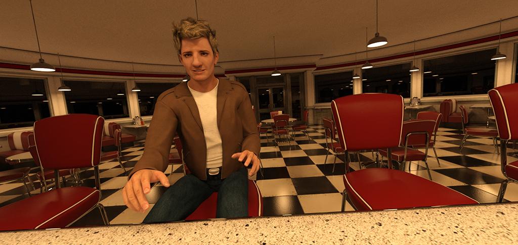

    This is my most ambitious picture so far. I bought the iRay addons for Moonshine's Diner. I used a Promo Image, and inserted Marlin into the scene. I placed a sky dome outside the diner in order to make the view out the windows more interesting. This image took 2 hours to render. I need to make some improvements later.
    1024 x 485 - 459K
  • Skydomes don't really work in iRay. You could probably delete it and get the exact same render.
  • NylonGirlNylonGirl Posts: 2,370
    I think you should check the CPU usage and see if you're using the CPU or GPU to render. When I first got my laptop, I assumed it was using rhe GPU because it was so much faster than my old computer. But it turned out that was just the effect of going from an i5 to an i7.
  • rrwardrrward Posts: 556
    That is quite the camera angle. Moving from Poser's Firefly renderer to Iray in Studio took me a few months to get to where I felt like I had any command of my lighting. And that's with 15 years of Poser under my belt. Once you get the hang of lighting with Iray you can do amazing things. I used to spend hours faking reflected light in Firefly among other things that IRay does by default. Glad you are enjoying your new computer and having fun with renders.

    I checked. The image is rendered in iRay! I had the sky dome because I didn't like the way the windows looked without a background outside them. Unfortunately, I had some unwanted lights in the image. I took out the sky dome. I don't like the look of the windows without a "world" outside the building. This was another 2 hour render. I need to reorganize my computers so I will have a free computer to use while this one is rendering.
    I don't think I want to make many 2 hour renders. It really  cramps my style. Sorry, I forgot how to get the larger sized image to show here.... without getting a duplicate post.
    1024 x 1331 - 1M
    Post edited by Ron Knights on
  • If it took 2 hours and your computer was completely locked up then it was rendering on CPU not on the GPU.
    I'm not sure why you're getting reflections with a skydome and none without. That seems very odd. But for best results you generally want to use HDRI's instead of skydomes for iRay.
  • The computer was not locked up. I just don't want to use the computer while doing a render. The log clearly states iRay rendering. Moonshine's Diner is a wonderful scene. However, there is no "background" outside the windows. When I did a render, the windows looked like there were a bunch of dots in the. However, the final render doesn't have that problem. The only purpose of the Sky Dome was to keep from having that pixelated empty window look. Now it's apparently not needed.
  • BobvanBobvan Posts: 2,653
    I usually add an outdoor scene out the windows using the enviro plane. A poor man's HRDI..
