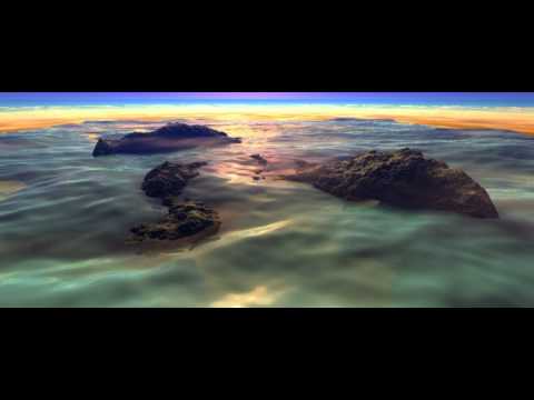

  • 3dcal3dcal Posts: 183
    edited July 2012
    Here's one I did a while back.......just an ebb & flow. :)
    (can't use the script for some reason.....have to copy/paste the url)
    Post edited by 3dcal on

    Very nice!
