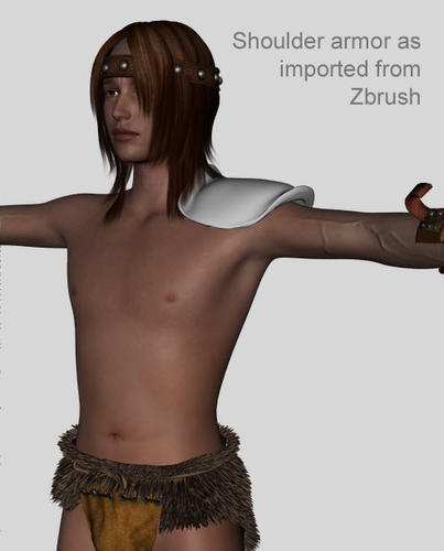

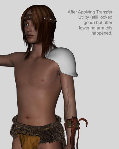

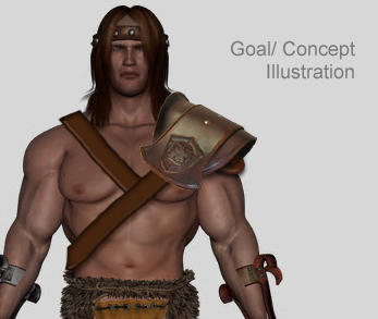

I've just started playing with the Weight Map brush, in Paintbrush Mode, (Daz version 4.6 pro 64bit) and am excited as it looks like it will be the solution to my problem.
My Goal: Make my shoulder armor plate (pauldron?) hold its shape, rather than conforming too much, when I use the Transfer Utility, and when my Genesis character's arm is raised/ lowered.
I've watched this video, and it gave me a good start: "Rigging Modification Intro Pt 3 Weight Maps Brush" on YouTube.
I've been getting the hang of increase the armor's rigidity in the area's I've been painting red. But don't see how to paint "blue" (or erase the red) if I overdo the red areas.
If I'm not being clear, I've included some screen shots of my efforts below:
Please explain how I can paint BLUE - instead of red.
