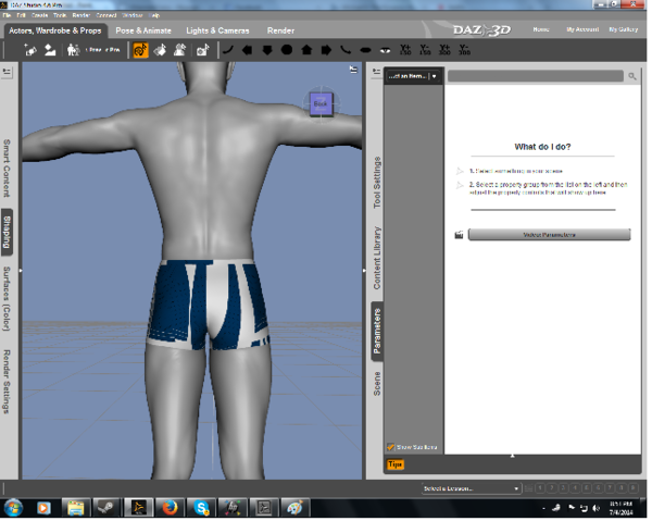

I just got the M5 dynamic wardrobe and nothing seems to be working ,the textures are all messed up and the shirts don't seem to fit right. Am I missing some software or plugin? nothing was listed as been needed on the store page.

    After fitting the dynamic items they need to be draped -- go to Window > Panes > Dynamic Clothing
    Some dynamic items have different Styles -- you set them at the bottom of the Dynamic Clothing pane. Each Style has different material presets.
