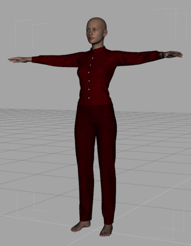

    I hate to say this but something is off in your installs I have the Everyday Wardrobe installed by DIM and it works perfectly as it should. I do not have the others to test but If one works all should.
    654 x 840 - 208K

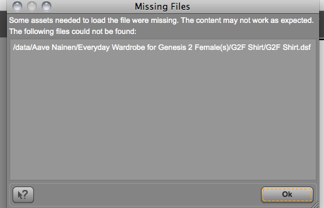

    Now I just tried loading the shirt from the Everyday wardrobe and got the alert again. I'm attaching it.
    The file is *exactly* where the program is looking for it. It isn't under another name, it isn't in another file format, there isn't an additional folder sitting anywhere in the path. The file is there. The file is *exactly* where it is supposed to be. It is *exactly* the file name and format the program is looking for. The program cannot recognize it.
    And of course there is no 'Locate' button as there is when you try to load or apply something and the program decides to make you work for it.
    This is Studio 4.6.1.39 on a Mac running Snow Leopard. Not that that is likely to be a part of the problem.

    Did you HAND create the
    (main folder)/data/AaveNainen/ folder here? If so there is the Error This Folder is NOT spelled the SAME as the folder listed in the Error
    (main folder)/data/Aave Nainen/ is not a match.
    Data folders should just be copied into the Data folder and not hand created. So you may end up with many Aave Nainen folders in Data but that is how it is supposed to be for some items. IF and only IF the names match 100% can they be in sub folders from that part on down.

    The folders are drag copied into their final destination. The only one that I named is the main one. Admittedly, the AaveNainen folder was drag copied over with the first product from the vendor that I purchased. If the spelling has changed since then I did not notice. Will check that.
    Yes, I split content into multiple runtimes, all on a peripheral hard drive.
    Found the issue regarding the GirlfriendZ shirt. There is no shirt. No shirt at all. All the data files are for morphs of a shirt that apparently either is from a different vendor, attaches to the free T-shirt from the Xmas package (which does not load) or was left out of the packaging. I haven't checked the store page to find out which.
    ETA: Yup. That was it. The spelling has changed. So that vendor needs two folders in the data folder. Easy to fix once you know what's wrong.
