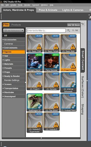

Against my better judgement - I updated my DS Pro 4.6 to the newest version this morning, and although I have scenes I've created and saved available in my content library (thank God!!), the Smart Content isn't working hardly at all. When I try to use most items in my Smart Content, I get the message that the ".duf file does not exist". I've tried investigating via Google and the forums here, and although I've found a few queries to the same, I've not seen much in the way of a solution. Everything was working perfectly until I applied the update. I also made sure that I downloaded and installed the PostgreSQL CMS alongside the update. Any help is greatly appreciated, and thanks for anyone's time!

  • fixmypcmikefixmypcmike Posts: 19,741
    In the Smart Content options menu (the icon in the upper right corner with the arrowhead and horizontal lines), select Content DB Maintenance > Reset Database and hit Accept. Then Content DB Maintenance > Re-Import Metadata and Accept. It will take a few minutes.
    What happened is that there was some corruption in the Valentina database, so when DIM transferred the info to the PostgreSQL db some of the paths were corrupt.

    fixmypcmike - I seem to have found a line similar to what you were asking for - BTW - sorry for not responding after a certain point last night - there were fireworks to be set off for the 4th ;) I have enclosed a screen cap of the line of copy. Again, thanks for help! Also thanks DrHemulen for your help - if nothing else works I may have to follow your instructions, but lets hope that someone might be able to help us with a general fix for the situation.
    UPDATE: Not sure how fixed - but I will fully accept user error responsibility - I followed fixmypcmike's instructions again concerning the metadata, and presto! FIXED. ALL Smart Content is now fully functional!! For anyone who is having any problems try the instructions above via fixmypcmike concerning resetting data and metadata, and it should work. THANKS to everyone involved for their help!!
