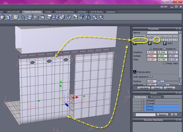

Without applying it, check the shape with level 1 or 2 smoothing.
Cancel the smoothing.

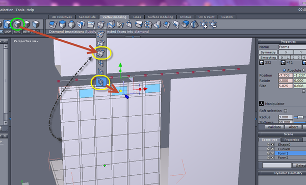

The top row, well do make a tight line to the top and for the side edges ... and have a row of faces made at the height you want the rope holes put. And have lots of vertical lines made to accommodate where each hole is to be placed.
Then select faces and select all the faces in which you want a rope hole.
Using one of the drop down selection tools [I know pictures would be nice, Hexie just crashed on me so have to redo this part]
select the one with a diagonal square in it.
Then select the squares to be made into holes and hit the delete key.

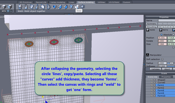

Then apply smoothing 1 level and see if the holes are right ... and if so, might as well collapse the geometry 'cause apparently Hexie might crash anyways.
If it collapses and looks okay ... "incre save".

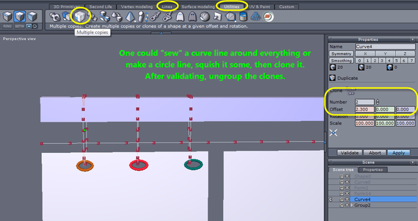

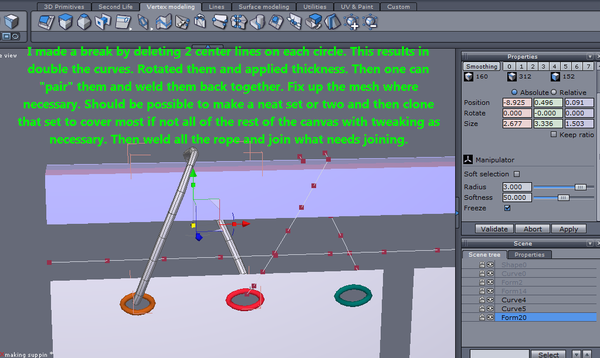

To make a rope ... theoretically one could take a line spiraled around and apply thickness.
edit to add pics.
and the rest ...
