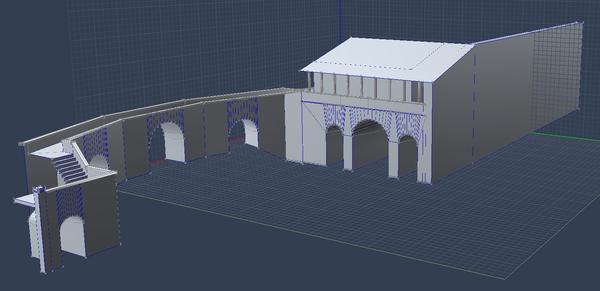

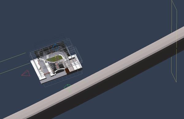

This really amounts to an issue of "best practice" rather than the nuts and bolts of "how to".
I have a vertex object, which is reasonably large and reasonably complex - it's a bridge with arches and a covered walkway with steps and a house on top (see pic). Now I built it as a single vertex object because it's logically a single model - there's a wall running all the way from one end to the other, for example (see pic), and everything needs to fit exactly.
I've split it into a number of shading domains - roof, walls, arches, pillars columns, steps, paths etc and UV mapped it.
The question now comes, how best to allocate texture sheets, etc. When I was designing stuff for flightsim, the "rule" was, fit everything onto a single texture, and map all the shaders to use it. So there would be a single diffuse, a single bump map and so on, with each shading domain allocated a specific area on it.
Is that a good practice also in Carrara? This particular model would probably need 2 4k texture sheets with that method - one for the bridge section, and one for the "dry arches" section. That actually throws up a separate issue, of how to export a template that contains 5 out of 10 domains. It seems that Carrara will only export "everything" or a single domain.
Or is it better to have each domain fill a texture sheet of its own? That will result in a lot of texture sheets, some being smaller and others containing lots of empty space.
If I were to decide to use a "material" type shader for a particular domain (e.g. a general stone or concrete etc shader), would that affect how I UV map it?
I'd appreciate your thoughts and comments. :)

  • 3DAGE3DAGE Posts: 3,315
    Hi Tim :)
    There's no hard and fast rules, but best practice, and the desire to show your model at it's best, determines that you allocate UV space to the areas that will be most visible, and sometimes that means splitting things up to add another Texture map (image).
    Don't be afraid of having multiple texture maps ,.. see any Daz figure as an example.
    Trying to fit the world onto a page, gives you very little detail
    for example, a vehicle: you may want to have a lot of detail on the bodywork, so you'd make that as large as possible,. then you realise that you're left with a tiny space for the wheels,. (which you'd like to detail with a tread displacement map) so the simple option is to create a new Texture Map and Shading domain for the wheels so that you can have the detail you need for that section.
    By splitting the model into logical sections, It should make the UV mapping and texturing process easier.
    it can also make the model more flexible , since the separate sections can be arranged as the user requires them,. perhaps they'll only use a wall, or the bridge, and add other models to create a completely different scene.
    hope it helps :)

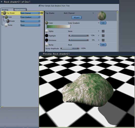

    Glad you found it! I see I forgot to link it! I'll edit the post in case anybody finds this thread at a later date!
    Here's a screen cap of the rock shader. It's pretty simple.

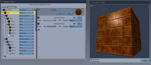

    I think I need to understand more about procedural shaders and the kinds of things they’re better for
    Procedural shaders can either be used as an alternative for texture based shaders, such as procedural brick, wood etc,
    or they can be added to texture based shaders to add more interesting effects, such as dirt and stains, or moss, etc
    and by building a few shaders which use the same texture map, but with different procedural shaders mixed into it, you can create multiple variations.
    Procedural shaders can also be used to combine (mix) several "texture maps" with procedural functions and colours to create more varied and detailed shaders. great for terrains
    You also have some different options when it comes to how the procedural shaders are mapped, whether you use the models UV's or use Global XYZ for mapping.
    I'd suggest starting with something relatively simple, like a Brick procedural. just to get the feel for what and how the different functions and options work.
    the Basic brick would be a Mixer, with two main colours,. Brick, and grout,. which looks kind of boring,. so by changing the "brick" source to a mixer, you can create a mix of two flat colours, and use a "Fractal noise" to blend them,. or you could use two Colour gradients, mixed with fractal noise,...which would give you even more colour variations.
    or you could take the simple Mixer of two sources, and make each source a mixer, (four colour sources)
    Try the same process with the grout or, "Mortar" shader, and you should end up with a pretty detailed brick wall.
    Hope it helps :)

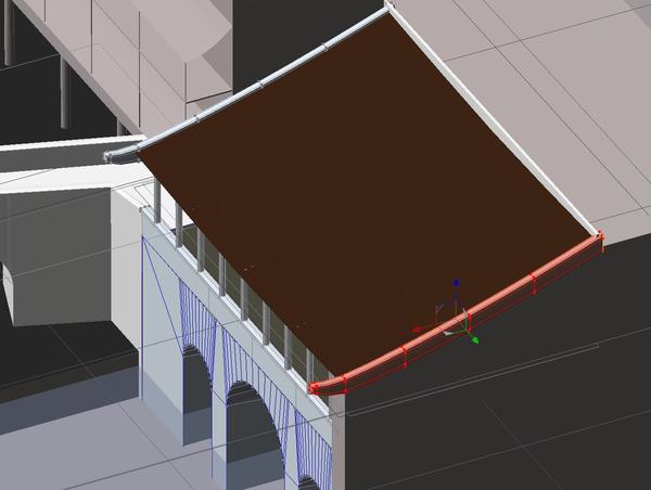

    I think I've buggered up my Carrara somehow - no idea what I did, but now I can't vertex edit in the assembly room. At least, I can't select anything. No matter whether I click, double click, drag a marquee around the object, nothing gets selected unless I go to the vertex modeller room and select it there.
    Also, and even worse, I'm trying to split one vertex model into multiple vertex objects. So I select the model, copy it and paste into a new empty vertex object. Yesterday this worked fine. Today... I get a giant version of the object half a mile up in the air!
    I have no idea what I did to make it behave this way! Any ideas how to get it back to normal? Thanks :)
    HI Tim :)
    strangeness abounds..
    I've no idea why the vertex modeller is causing issues,. but there is a way to easily break up your single vertex model.
    Edit / Split object.
    Try cleaning out your Daz Temp folder,. see if that fixes the VM issues.
    MyDocuments / Daz3D / Daz Temp.
    You should do this regularly, since carrara doesn't clean these temp files, it just creates a new one each time.
    all the files should be 0 bytes, unless it's a temp movie file,. they should all be deleted.
    Also,. save your model to the browser, My objects / My buildings
    that should make it easier to load

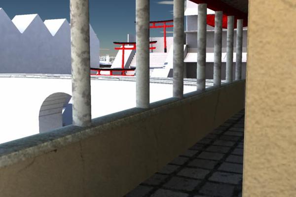

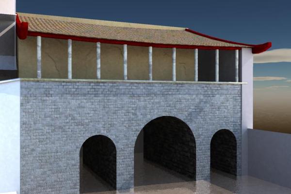

    There are some issues of scale, and shininess, and bump intensity, but I think progress is being made...
    The columns are showing the seams in the first pic, and I think it's hard to spot the join, so I'm pleased with that (it's a wrapping texture done in FilterForge) :)

    That is looking really nice, Tim! See? You know how this works! It can be a PITA, but it's so worth it in the end!
    I know all about that, as a stone worker. Starting with having to dig out whatever's there to begin with, installing a good, compacted new ground footing, piecing in, cutting and chiseling heavy stone, and finally lifting them all again to create the final leveling... PITA, but worth the effort! ;)
    It's shown up that I need to add in facing stones around the arches, & I need to figure out scaling - when I added the same texture to the next bit of the model on the left, it came out completely different. I think if you size the UV bigger than the grid in the editor, the texture sheet just repeats, yes?
    I'm also going to need to add little detailing effects, like a treatment around/below the waterline, streaks and so on. But that can wait for another day! :)
