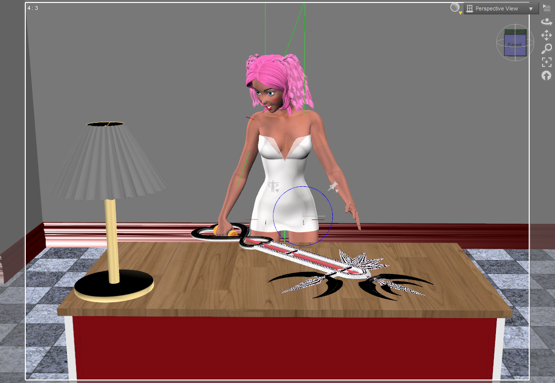

     i'm making an animation wherein  Gabbie takes a keyblade , manipulates it, then puts it back on the table
    using mcjParent and mcjMakeTarget and I wrote this short script that shows how to store a figure pose at a far point on the timeline
    I thought this may interest you
    using something like this, one could copy the pose stored at frame 300 and paste it at frames 0, 60, 120, 140
    then take the pose stored at frame 301  and paste it at frames 30, 90, 130
    the interpolation between the 2 poses would be Daz Studio's default splined interpolation
