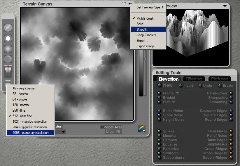

  • HoroHoro Posts: 11,690
    edited August 2020
    Good. Select the terrain and click on the [E] to open the TE. The rest is in the picture.
    TE-Resolution
    823 x 568 - 78K
