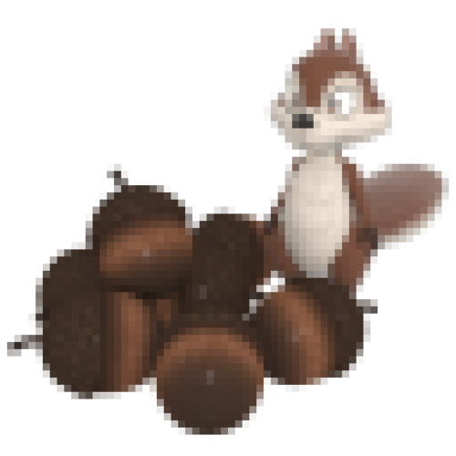

    Yes, as Sean said above, after rendering out your image "very small", then scaling it up in an image editor (without no interpolation) was the final step. Below is a quick sample, with and without an extra grid laid on top - I rendered at 128x128, then scaled it up 4x to be 512x512. Did you want to do this for a still image, or for an animation? (it's a bit handraulic at the moment - quite tedious if you wanted the animated effect...).

    In GIMP 2.8, there's Filters -> Blur -> Pixelize, as well as Filters -> Distort -> Mosaic... and if you have the "G'MIC" addon, there's a "GMIC -> Arrays & Tiles -> Grid" as well (shown in order in the attachments below). All of these work on a render at the "master" size (as opposed to making a small render and scaling it up).

    There's always another way ;-). If you have a directory called "JorgeDir" full of rendered .png files, then (in Win7, in a DOS shell) using ImageMagick will be the simplest and least effort:
    cd JorgeDir
    for %n in ( *.png ) do @convert -scale 10% -scale 1000% %n ..\FxDir\%n
    That will convert all the .png files in the JorgeDir\ into a directory FxDir\ - 1000s upon 1000s of files will be completed in the time it takes for you to get a coffee (various other combinations and effects are possible). If you need to do it multiple times, or want to re-render, the above can be placed in a batchfile for convenience. Below is an example of what the ImageMagick effect will be. The command under Linux and OSX is similar - sorry I don't recall what sort of computer you have <(^_^).</p>
