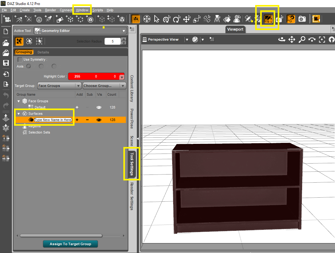

    Renaming surfaces can be done easily in D/S. Use the Geometry Editor tool and the Tool panel. Name changes on the tool panel are reflected immediately on the Surfaces. On the Tool panel, Right-click on the names of any empty surfaces to remove them. Double-click to type a new name.

    I cannot find how to change any of the surface names.
    The geometry editor does not appear to have any option to change surface names that I can find. Does that have to be done on initial inport prior to saving as a prop?
    Would appeciate a little more detailed info.

  • With the Geometry Editor active the Tool Settings pane will list the groups on the model, and allow renaming by double-click.
    Thanks
    I said - the Tool Panel. [panel = pane = tab]
    Windows > Panes > Tool Settings
    Feel free to Explore, there are lots of panels, panes, tabs, whatever you want to call them.png
    1070 x 809 - 165K

  • Thanks !
