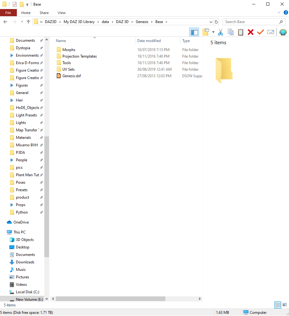

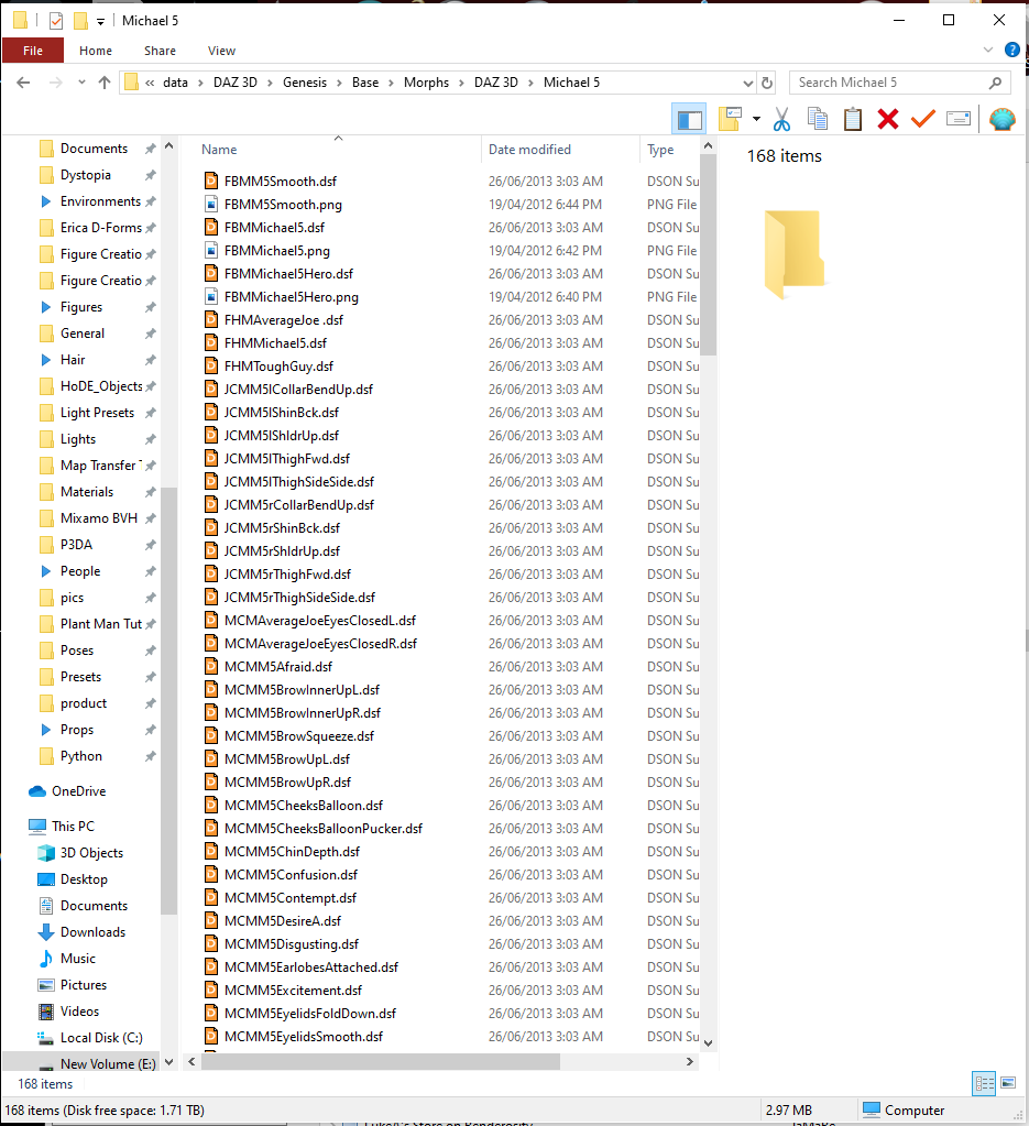

    First of all can you open the basic Genesis figure ?
    Your figure should be showing in the screen with a list of the body parts in the Instances Tab.
    Also check your data to see if M5 is installed, as well as Genesis.
    2269 x 1037 - 416K
    926 x 1015 - 62K
    935 x 1023 - 130K

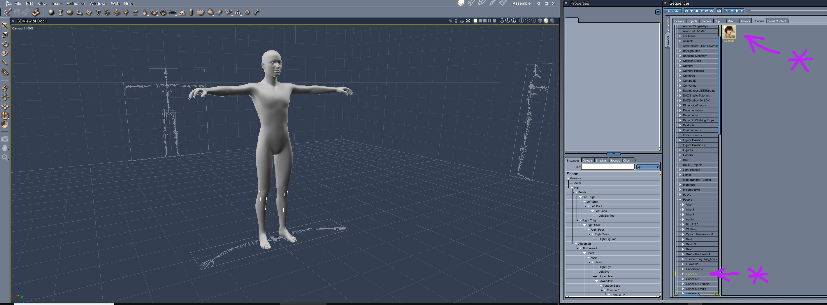

    hello,
    I think you are dropping a material set onto the scene rather than the figure
    1293 x 951 - 823K
    Post edited by Headwax on

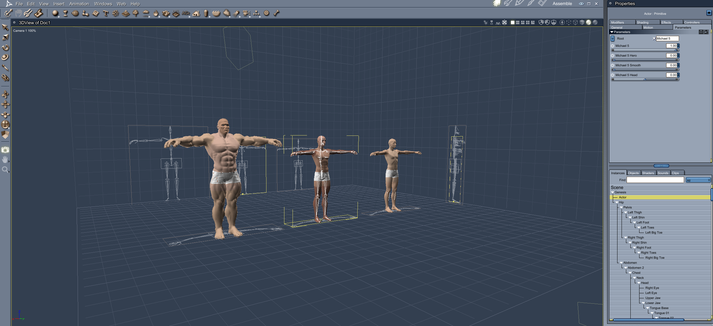

  • UnifiedBrainUnifiedBrain Posts: 3,588
    edited August 2020
    Headwax is correct.  You are trying to load a material set, instead of a base figure.
    There are several ways to load the base figure.  Above, Headwax is using the "Content" tab.  But since you are using Smart Content (as do I), below is an expanded view of the tab you previously opened.  Instead of clicking the top left box (which is a material preset), you should select a box near the bottom right (the Michael 5 figure).
    Another way in Smart Content, you can load the base genesis male character from Smart Content>Genesis Starter Essentials>Genesis Base Male, and them apply Michael 5 morphs.
    1476 x 899 - 291K
    Post edited by UnifiedBrain on

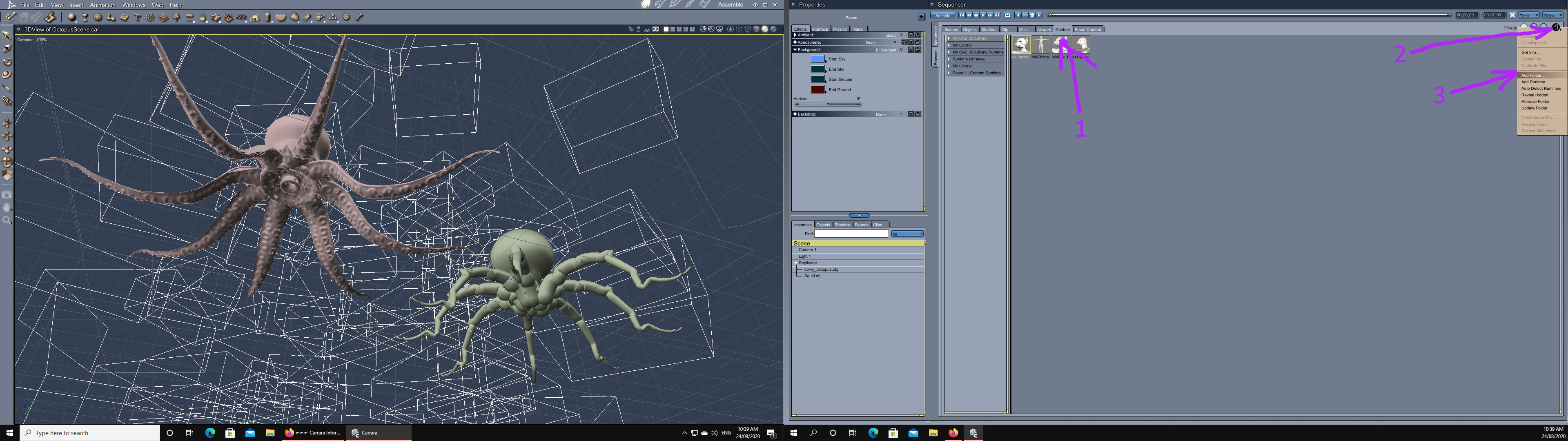

  • What is this error?
    2242 x 1536 - 711K

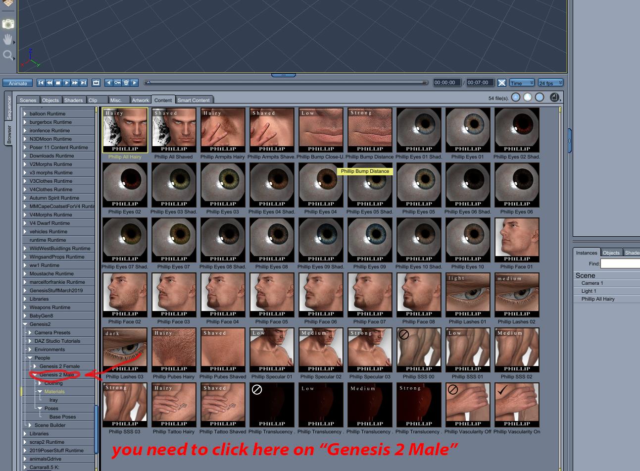

  • WendyLuvsCatzWendyLuvsCatz Posts: 41,814
    edited August 2020
    on the first one, some of those poses for genesis 1 never worked in Carrara and I used the Poser runtime equivalents instead as most of them had Poser companion files, the cr2's were incompatible but the pz2's worked.
    try using the ordinary content tab, smart content sometimes shows stuff in a dumb way depending on whether content management service is running or not, DAZ studio often needs to be installed and populated with CMS to kick it into action too, this might solve everything if you haven't installed and run DAZ studio and run the metadata.
  • on the first one, some of those poses for genesis 1 never worked in Carrara and I used the Poser runtime equivalents instead as most of them had Poser companion files, the cr2's were incompatible but the pz2's worked.
    My ordinary content tab shows nothing (just empty), but I'm sure I installed those Genesis. Is it because of the installation path?
    What is this error?
    Not sure.  I only get that error when I try to load Genesis 3 or 8 (and shortly afterwards Carrara crashes).  I also pretty much never load characters from the "Categories" tab in Smart Content.  I always use "Products."  However, I tried to load Dragon Slayer as you did (from Categories), and it worked fine.
