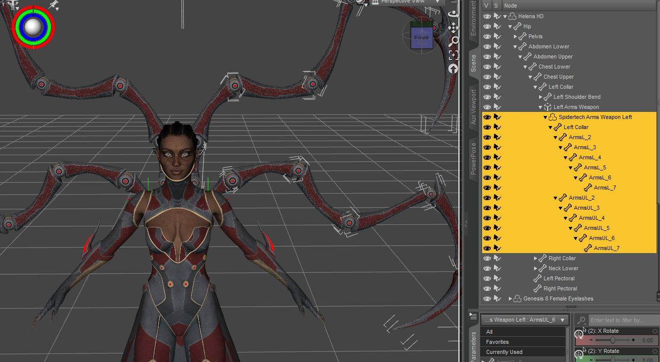

The joint and the arm are one bone, they are not separated even when I expand the limb. There are bones, but no nodes for the individual joints. Please see attached:
If you note on the right side, the left hand arms are expanded fully with all the arrows down. There are only bones, no nodes. So something fishy is going on here.
Geo

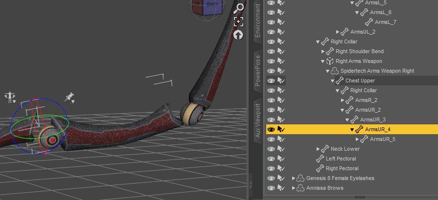

I know it has been a while since I posted here last and that was mainly because I was fed up with this issue. At any rate, having more time today, I figured I would post my findings. I did EXACTLY as you said, and the joints STILL separated. Here is a photo showing this:
As of now, it is a moot point as I returned the item. It clearly is a defect as I NEVER had to use the rotational control to postion joints before on other products. Given that the skirt controls weren't working either, I just chalked it up as a bum product. It is a shame too because the artist did a fantastic job on it visually and artistically, but sadly, he/she didn't take the proper time to make sure that it was mechanically sound and worked to standard. Don't ask me how or why you are able to get it to work, I can't. Perhaps we are on different versions of Daz. I am using 4.12
