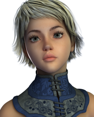

I'm still trying to get the hang of lighting and shaders. This is my latest. Rim light too bright? I'm using AoA, for some reason I'm getting discoloration around the bridge of the nose. Any thoughts?

  • srieschsriesch Posts: 4,243
    I think it looks quite good, but as the background is just a solid color, I don't know what the lighting is supposed to look like. It appears to me as though there is a light source in that direction (rather than just ambient or sunlight). I'm not seeing the discoloration on the nose, although once again I don't know what the original material looks like without lighting.

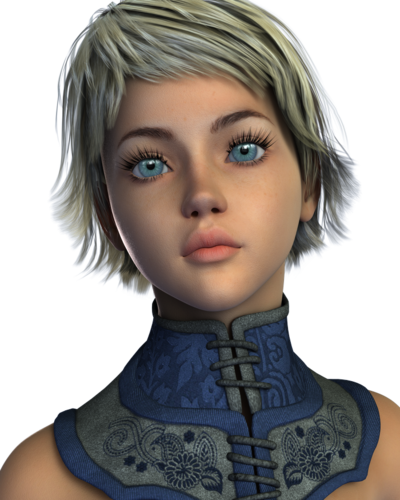

    Thanks for the reply, sorry I didn't load the BG up. I see and read about the realistic looking renders and how the lighting and the skin is so important. I'm trying to get my head wrapped around it all. It's basically just a portrait with a distant light and UE2. I tinkered with the skin some to try to get it to look realistic. On the face it looks flesh colored but a bit pale across the bridge of the nose and under the eye brows but, maybe that's just me.
    Ok, I see the pale area that covers the eyebrows and top of the nose now. It's very faint, but yes, it is there. Not sure why that is happening though.
  • JaderailJaderail Posts: 0
    If you first look right between the eyes at the bridge of the nose and then swap to that light area of the right cheek (left side on screen) you will notice it too is almost the same in a place or two. That to me says it is the figures texture and how the light reacts to it.

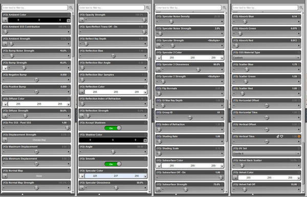

    Thanks for replying. Here my settings and the other 2 maps. Gamma is at 1.0

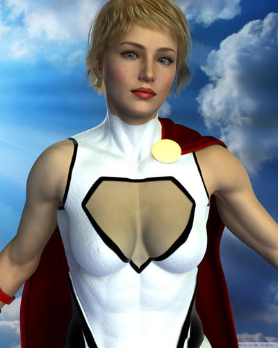

  • HitManWAHitManWA Posts: 152
    Here is with the defaults...
    edited June 2014
    The Brow issue is most assuredly the Diffuse Texture... Highlights and shadowing should not be built into a skin texture but often are. It is the lighting's job to do shadowing but some resource sets still come with cooked on effects that are not needed.

    First off, I don't think you should have posted the textures. Those are copyrighted images that belong to DAZ or whoever the PA is.
    I don't own Giselle, but if you look at the promo pictures you can see something like the bluish area between the eyes on some of them.
    Having looked at the diffusion texture, it looks really white to me in that area. The specular color is light blue (225,237,255). Try changing that to white and see if it makes any difference.

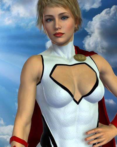

    edited June 2014
    Haven't had much luck with it, plan on tinkering with it some more this afternoon. I have been playing with this. Figuring out how to make maps and lighting still befuddles me.

    Don't feel bad, I still haven't figured out lights like I would like to (I have the "SpotLight..." in the Create menu down, and that's about it). I did notice with some figures (Wachiwi), Shadow Bias can make or break how the figure looks. Especially with clothing on skin shadows, and plastic hands.
    Unfortunately, it is a value that seams to be optimum in a range relative to the size of the render. (1.0 looks good at less then 800x800, 0.1 is ok up to 1600x1600, etc). You kind of need to fuss with it based on the render size, and the textures in the scene.
    If your doing SOI chip logic bump-maps on the floor, forget it, it's just not going to look good, lol.
    Thanks, playing with the bias now. I changed the pose up a bit and tried to clean it up some, I may have overdone it.
