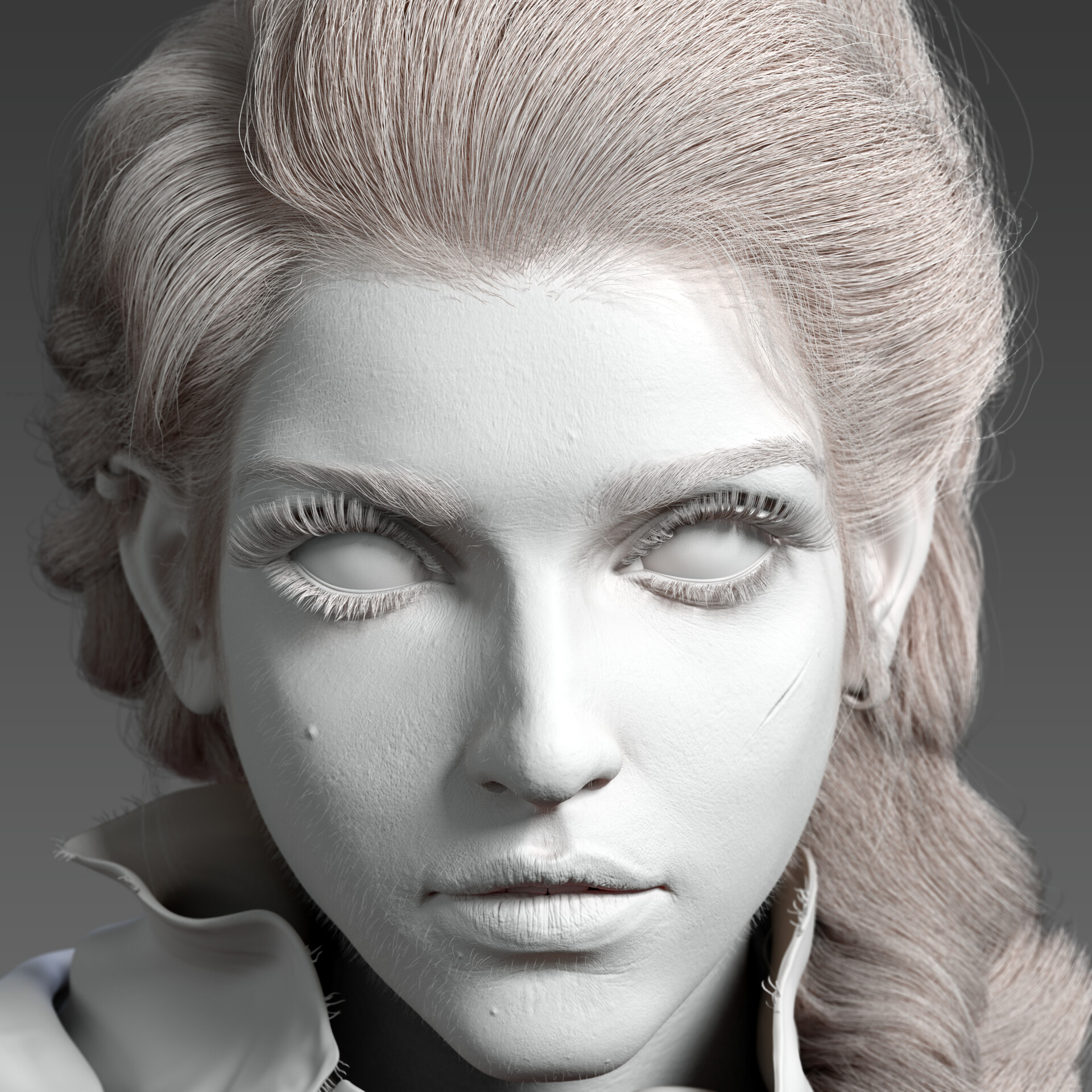

Perhaps overlooked in this is that Tara was originally designed not as a Daz Genesis character, and the renders of her original form were done in Arnold, not Iray. https://tristanliu.com/projects/58YQv1
Arnold will not have dforce hair, so it had to handle this hair differently. Also, like I said in the Tara thread, the original Tara has fiber mesh lashes and peach fuzz, on top of all this other geometry. Her fiber brows look much better, too, and if you compare the hairs close, the original looks even more dense than the Daz dforce one.
If you look at this, you will even see more fiber strands coming out of her clothing. So there is a ton of stuff going on here and tons of complex geometry. However it is true that these renders do not show much of a background around her. At any rate, it looks like she has been altered to work in Daz Studio.
