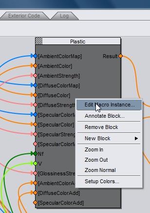

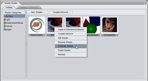

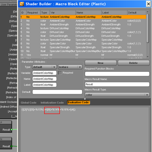

Bring up Shader Builder (View->Tabs->Shader Builder). The active tab should say Catalog, below it is a panel labeled Shader Categories, and several shader categories are listed below it. Click on the one named Surface, if it isn't the default. In the panel on the right you'll see four icons, one of which is named DzPower. Right-click on it and select Duplicate Shader, and give it a name. I named it DzPower Ambient. Double click (or right click and select Edit Shader) on the newly created DzPower Ambient shader. A new window will appear with a number of squiggly lines going to and fro. Roughly in the middle of those lines will be a largish block named Plastic. Again either double click anywhere inside the block, or right click on it and select Edit Macro Instance. This will pop up yet another window. In the bottom part of this window are three tabs, named Global Code, Initialization Code and Evaluation Code. Click on the latter: you'll see a short line that probably says (probably, because I edited it :lol: ):
(§2§*(§6§+%+§5§+%)+%+§4§)
Cut the §6§+% part and paste it outside of the parentheses that are multiplied by §2§, such that it looks for example like this:
(§2§*(§5§+%)+§6§+%+%+§4§)
Ok, we're done, click Accept. I clicked on Save Network just under the Atmosphere Code tab on the window with all the squiggly lines, then closed that window. Now we're back at the Shader Builder main window, right click on your new shader and click on Apply to selected surface(s).

    However the formulas haven't been copied correctly. :-S They should be respectively:
    (§2§*(§6§+% 14%+§5§+% 15%)+% 16%+§4§) (Note that there are no spaces between % and each number following it, but the forum code breaks ands shows just % if I leave them as they are).
    and:
    (§2§*((§5§+% 15%))+§6§+% 14%+% 16%+§4§)

    I'm attaching the significant pictures. The ordering should be: picture ending with 2_2081503.jpg should come first, then 3_2081503.jpg then 4_2081503.jpg.

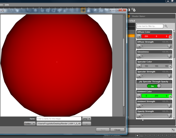

    When you make a render you have to add colours in some fashion. A visually oriented explanation would be something like this:
    Put 255 red in your diffuse channel, and 255 green in Ambient.
    Make sure both are at 100% strength.
    Screenshot with yellow green sphere shows the OpenGL preview.
    Screenshot with red sphere shows the 3Delight render of the same scene.
    I thought you could force the DAZ default shader to give the same results if you left both Diffuse and Ambient Colour to white and applied a 1 pixel *1 pixel red texture to Diffuse and likewise 1 pixel * 1 pixel green texture in Ambient. But actually that doesn't work and I don't know why. Basically if you do that the OpenGL preview gives a perfectly red sphere (no diffuse to speak of), but the 3Delight render shows a red ball with very definite darkening towards the edges (i.e. a diffuse look). Still, it's vastly less different than doing it the other way, and doesn't require messing with shaders.
