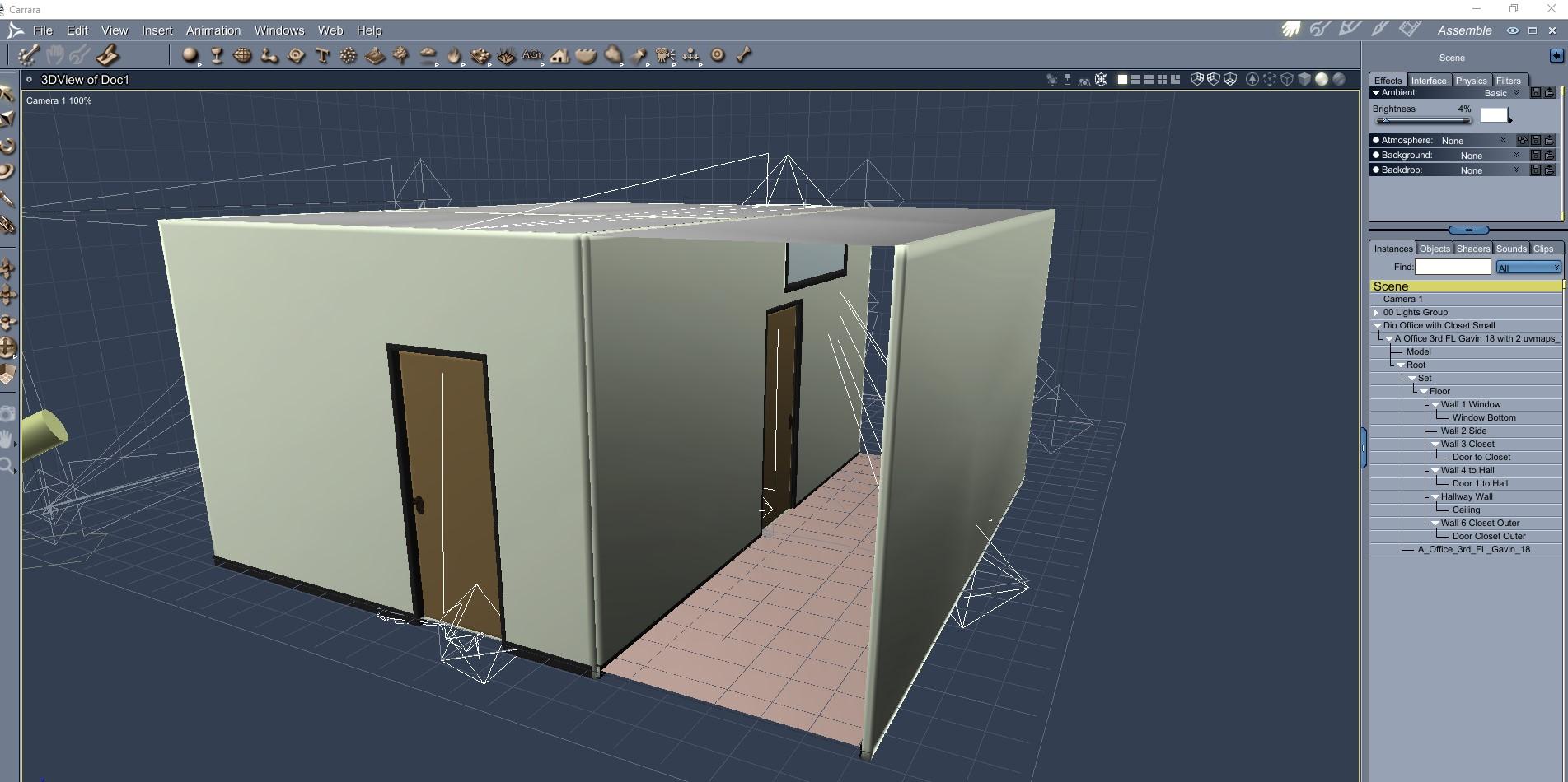

In this first screengrab, the set is loaded in Carrara with simple shaders.  You can see in the hierrchy on right that the walls and doors are rigged using the floor as the base or 'hip'.  Focus on the door inside the hallway.

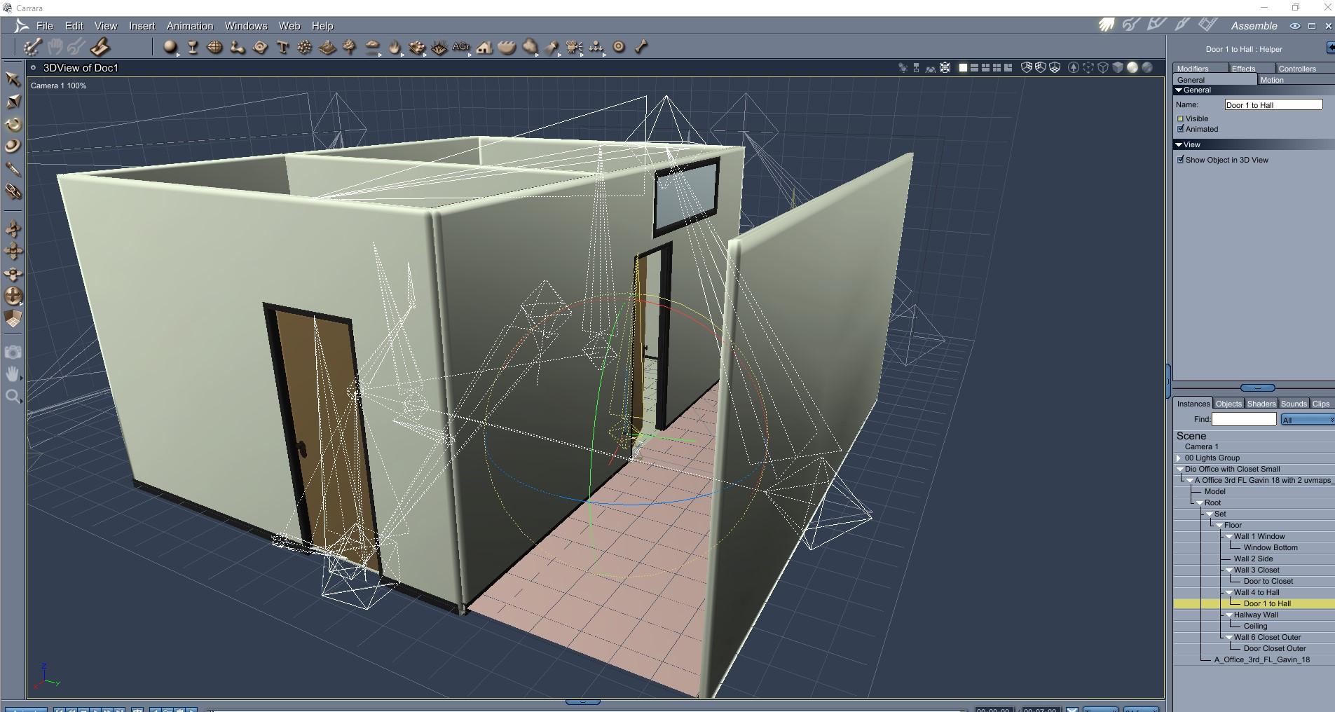

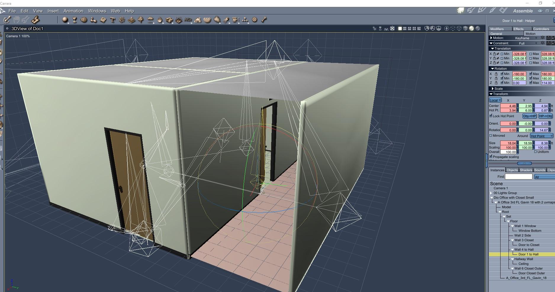

In the second screengrab, I've selected the door to the hallway and rotated it.  The door to the hallway opens inward (I have set parameters to prevent opening outward).  All seems well.  But please take notice of the gray (grey) ceiling sitting atop the set.
In the third screengrab, with the hallway door still selected, I unchecked the visibility box, but instead of the mesh attached to the door bone disapearing, the ceiling disappears!

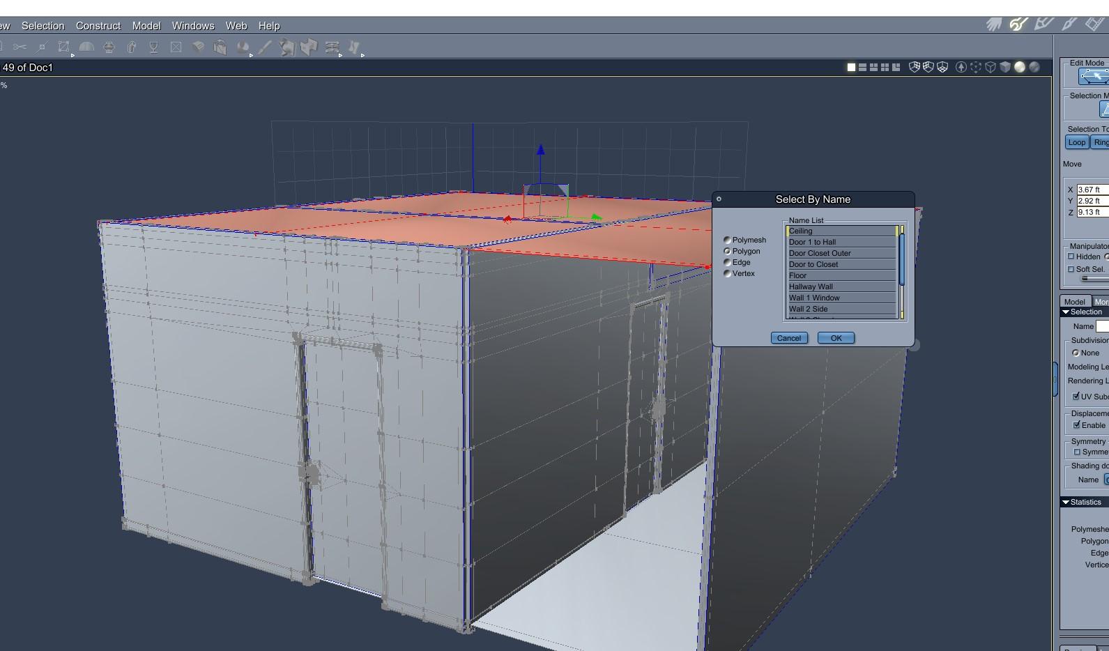

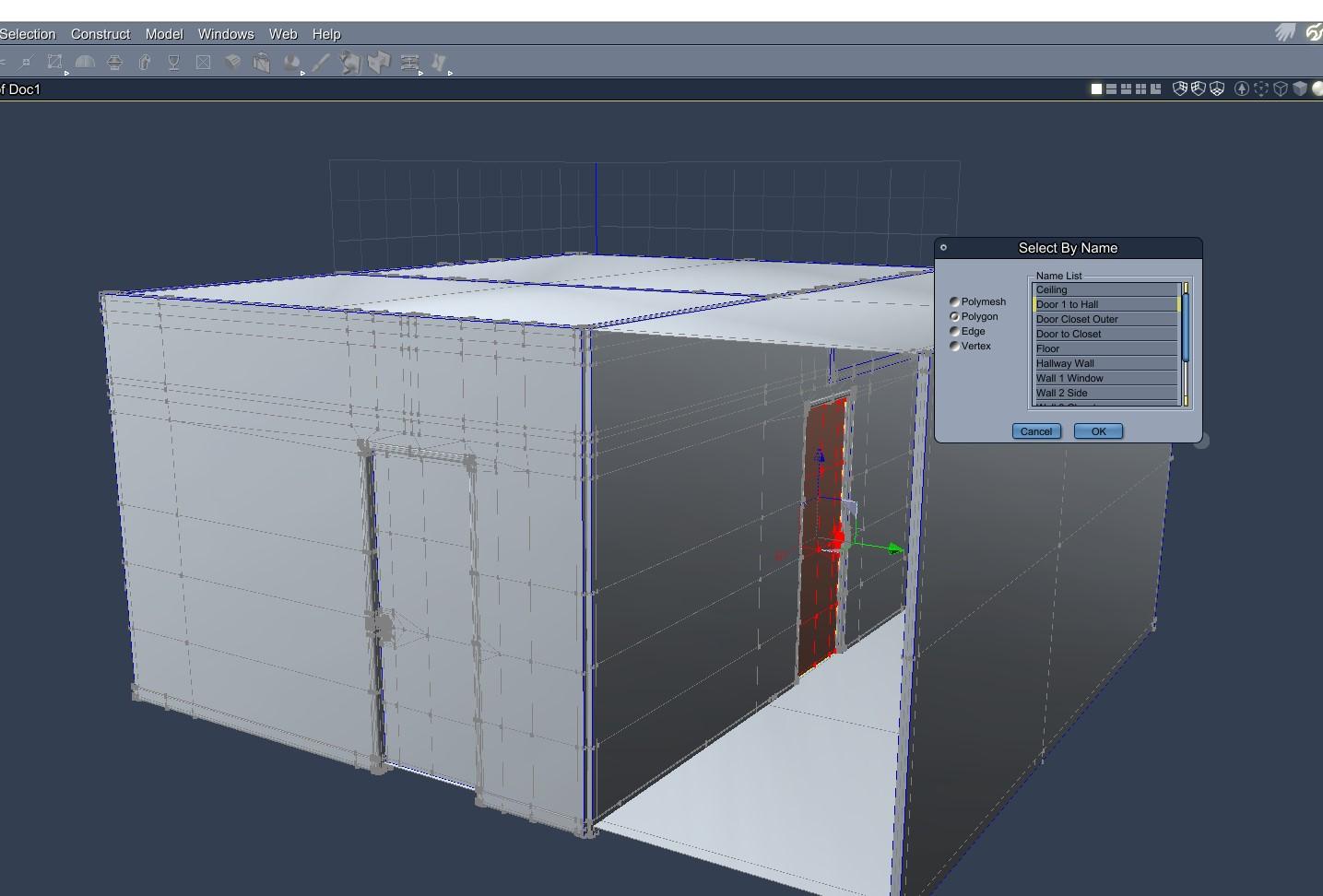

I went back to the original Carrara model.  I selected by named polygons and did the door and the door is selected.
I repeated for the deiling, and the ceiling is correctly selected.
