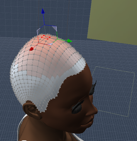

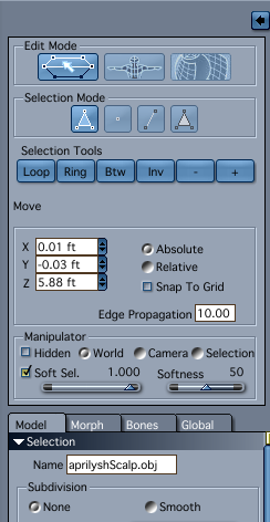

    If scaling the X, Y and Z coordinates doesn't work, If the object is a prop and not a conforming object, parent it to the head and position it as close as you can get it. Then select the model and click the wrench icon on the top left of your screen. The object should appear as a vertex object, now select a polygon and then on the right side of the screen look for Soft Select and enable it. You may have to adjust the slider to decrease or increase the range of the soft select. Now, use the translation tool to move the poly in or out, forward or backward, etc. You're not creating a morph, you're just adjusting the mesh and since it is not a morph you can't animate it.

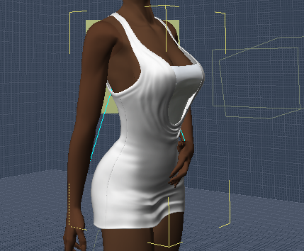

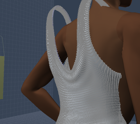

    You can use the same method with conforming items as well, but in C7.2 and maybe C8.1 (not sure if C8.5 fixed it) when the model is being edited in the Assembly room it is displayed in its default position, unless you're in Animation mode and creating a morph. The mesh can be edited as I described above, but it takes a little more trial and error.
    The images below show what it looks like with a parented hair cap and a conformed dress. The hair cap keeps it's position and the dress defaults to its starting, non-conformed state.

    The other method I mentioned is also very easy and isn't really modeling. You're just selecting a poly in the trouble spot and changing the selection behavior from a single polygon to a gradual fall-off of influence the further away from the selection it gets. You're really just translating the position of the polygon, except you have a bit more control. For the longest time that is the only reason I even opened the vertex modeler.
