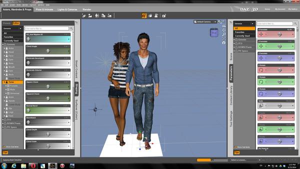

    Okay - this is ALL that is in the scene with Genesis - and yet - posing it, moving him, is maddening! PLEASE has anyone had this problem, know if this has happening to you?
    My graphics card is up to date! Below is my system info...
    Windows 7 Home Premium 64bit
    ASUS AMD FX 6100 Six-Core Processor
    nVidia GeForce GTX760 2gb ram graphics card
    16gb ram - 1trb drive
    Daz Studio 4.6.3.50 Pro
    Accuratus mouse
    Help please! I will be using Genesis Michael 5 a lot and I can't work with it like this!

  • MattymanxMattymanx Posts: 7,002
    SimonJM said:
    having a lot of items with collision/smoothing enabled will tend to cause delays and 'stutters' in the viewport.
    Mercedesk,
    Select all to the clothes on Genesis and shut off the collision then pose the figue. After you are dont posing, turn the collision back on.
