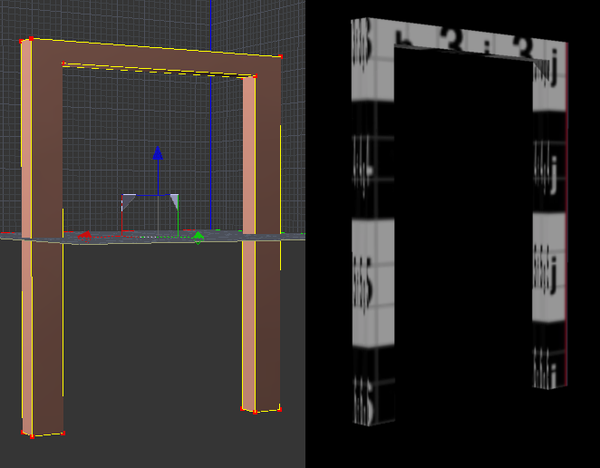

why are the uv's crunched up on the inside polys? I have tried several mapping alternatives and cant fix it. such a simple mesh and im stumped. any help much appreciated

    The UV mapper in Carrara is quite buggy - particularly if you're using cylindrical etc mapping - you'll find that one of the faces has been stretched across the entire map.
    I now define seams and do a full unwrap on pretty much everything, even a simple cube. It's much faster than trying to figure out & fix up what the hell Carrara has done, and the results are a lot more predictable.

    Could you do us a screenie of UV view, with the problem ploys selected? It might help...

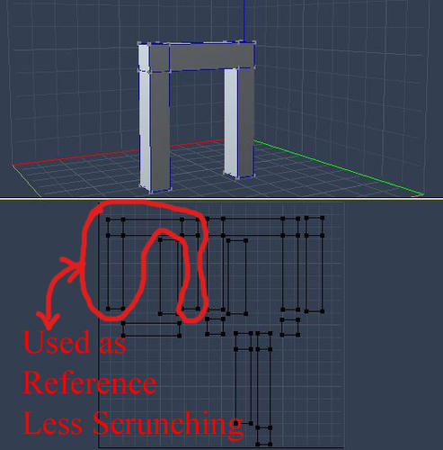

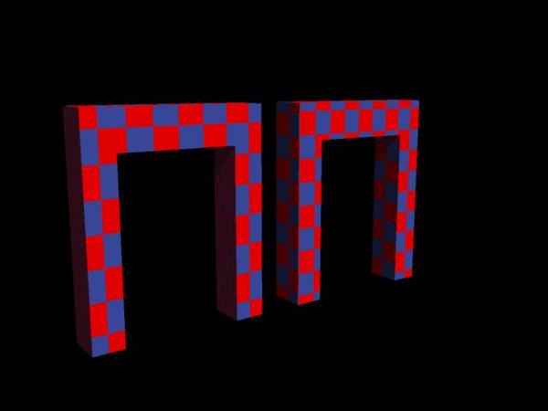

    Here is a thought, but is PITA. I suspect my suggestion is just a more primitive version of what Dart alluded to, but I will post so there is something until he gets time to illustrate.
    First, it appears that you have not modeled as quads. I'm not sure how much it matters, but I did my similar model as quads. I duplicated the model so I could illustrate 2 different uvmaps methods.

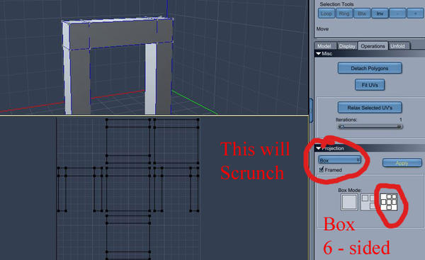

    Left side - When I uvmapped the model on the left, I simply highlighted all of the polygons and then chose the custom uvmap "box" choice with 6 faces. The resulting uvmap literally maps the polygons to boxes, even if the model is a rectangle. The result is "scrunched."
    Right side. When I uvmapped the right side, I assigned separate shader areas to the front faces, back faces, interior, and exterior. I then chose the front faces and then used custom uvmap with the "planar" in the y-axis. The result more closely preserved the rectangular shape of the legs of the frame instead of scrunching them in a box. I then used the front frame as a reference for the other shader areas. That is, I could use the box uvmap for the interior zone, and use the length of front frame as a reference to adjust the uvs of the interior.
    In the attached render, you should see that the checker shader is less distorted in the model on the right than the model on the left.
    EDIT: to see the biggest difference in scrunching, focus on the inside and outside faces of the models, not the front faces.
    As I said, for anything complicated, this could become a big PITA, but didn't take too long for the relatively simple shape in the example.
