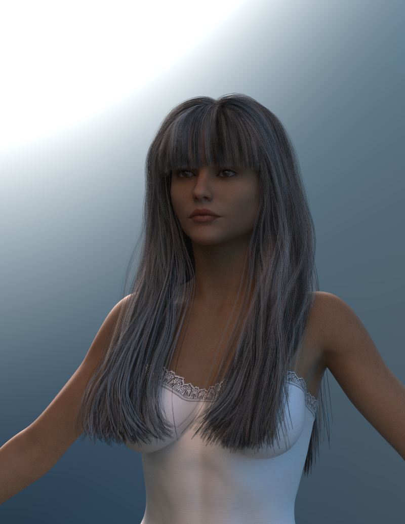

    What exactly are you trying to do; I found it a pain to deal with without tweaking shedloads of settings.
    I upped gravity to 2, then put the settings to something like the image shown.
    Incidentally, this was positioned above the Genesis (1) character; I could have parented it to the head, but for this there is no need. Dforcing gets it on top of the head and then the hair drapes. I only used Genesis to show it is easy for a simple pose to use any generation of character.
    You can also try setting the gravity to about 10 and not adjusting any settings, that works on some hairs well, but there can be issues with it intersecting other items. Depends what you're after
    I use Blender now for my renders so it's been months since I used this har, so I may not be remembering something I figured out.
    Settings with Constraint are worth looking at if something is not doing what you want; PAs often provide options to change settings, so it's always worth seeing what settings those change and if you like it increase the amount.
    I don't tend to mess with Stetch Stiffness - hair has very little of it.
    Dynamic stenght is also worth checking - it can be set to less than one. Bangs base and Outer on the MRL hair are less than one, but I mostly left as is, unless I wanted them to move.
    Settings shown in white indicate they've been changed from default; don't presume that because they are at default I haven't changed them. Don't think I set any to default though.

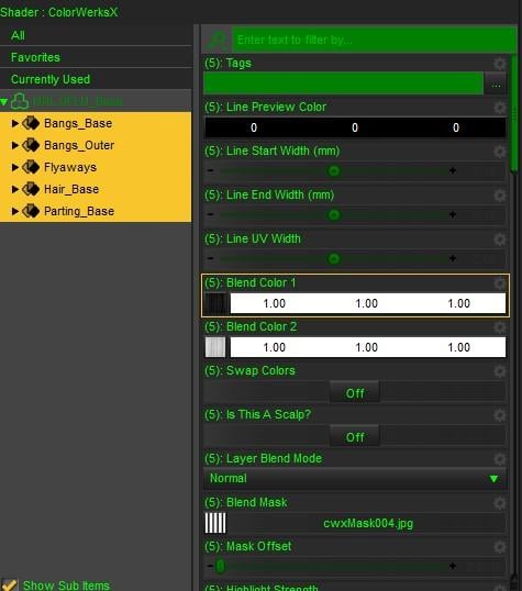

    These are shaders, so you'll need to be in the Surfaces tab, and preferably in the Content Library.  I tried this in Smart Content, and it wasn't as straightforward.
    For this hair, you select the base, and then in the Surfaces tab, select the parts you want to colour.
    Then you select your base colour from the Blend 1 choices, your blend colour from the Blend 2 Choices and the mask from the Utilities folder.  Those get slotted into the Surfaces tab as shown, and this is the result.   And they do work with this hair.

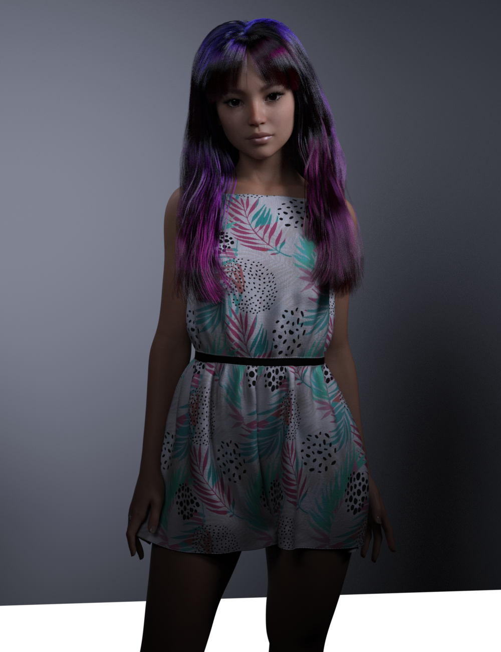

    For that, you might be better off with one of the MMX products?  ColorWerks is fine for streaks but MMX, while having a mind-boggling number of options, which really are badly explained, or rather are not explained, and some colouring options that suggest colour blindness - see attachments, and note the colour names and the colours that go with them - I think it's okay for this type of blending?  In the end I found myself dealing with the color chooser and inputting colours manually, and still couldn't get a result like I think you're looking for.  For example, I didn't select what appears to be a very dark base colour, but there it is.

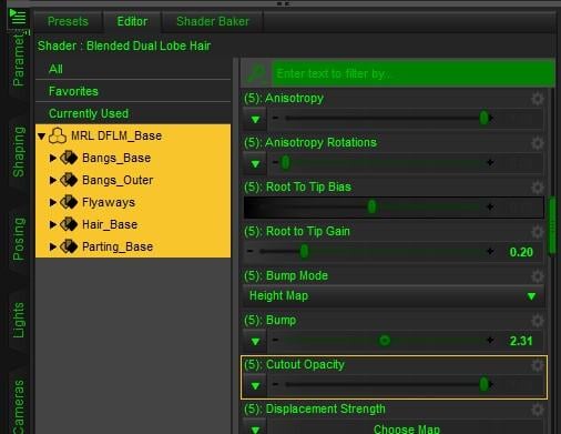

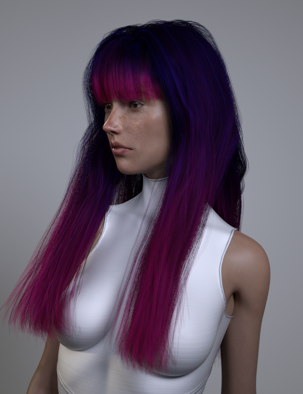

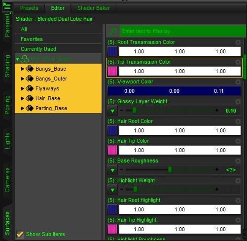

    Yeah, Colorwerks is pretty easy to use.  But it's not for ombrés.  However, SBH itself helps with ombrés!  You can pick one colour for the "roots" and another for the "tips".  In practice the roots are just the hair closer to the scalp and the tip is the closer to the tips. You can use the CWX colours, but don't use the "Colorwerks Shader Apply First" option.  That sets up the shader options for CWX blends and hides all the other stuff.   For an ombré, these other options are what we want.
    To get this result, I started with the blue colour that comes with the hair.  You can pick a blue from CWX instead.  That should be in all the "root" options.   Then in all the "tip" options, go pick a pink colour from the CWX options in Runtime/Textures/Sloshwerks/ColorwerkX/CWXBlends folder.
    In order to get a strong contrast, you need to adjust the "Root to Tip Gain" slider and move it to the left.   This is at 0.2, but depending on your patience, you can experiment here.   You can also play with the "Root to Tip Bias" slider if you want to give either the blue more room or the pink.
    If you don't want to recolour the bangs, then just leave those options untouched.
