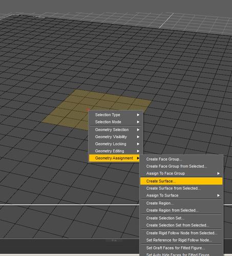

  • KeryaKerya Posts: 10,943
    Create / New Primitive - for the cylinders, cubes, planes (or the icon with a filled circle with a square and a triangle peeking out behind and a plus + sign in the top left corner)
    Geometry editor: for the icon I am adding a screenshot, toooo lazy to describe it, else it is Tools / Geometry editor
    Rightclick to choose your selection type (I just choose to use the polygon selection and painted a square)
    Rightclick on your selection Geometry assignment / Create surface
    653 x 721 - 153K
    171 x 63 - 5K

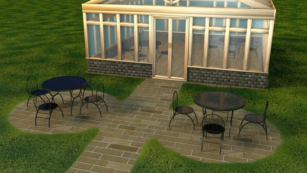

  • Peter WadePeter Wade Posts: 1,699
    Thank you all for your help. I've been having a go at this.
    I tried using cylinders for the round sections and this worked fine until I tried using the AoA grass shader. This creates wonderful grass using displacement mapping, but this means the grass comes up through the cylinder.
    For this attempt I went back to just using the geometry editor to create surfaces and went for a square seating area. It needs a lot of work still, but it shows that the principle is sound.
    600 x 600 - 318K
  • ZelrothZelroth Posts: 910
    I like what you have going there Peter. Are you trying to convince me to buy yet another of AoA's products? (Just kidding on that last. If I had unlimited funds, everything that I liked would be mine.)
  • SpitSpit Posts: 2,342
    Wow. Looks great!
    Turned out great! I actually like the square area the table is on more than the round. Contrasts nicely with the roundness of the table and chairs.
    Looks good!
    Isn't it fun what you can do in DS?

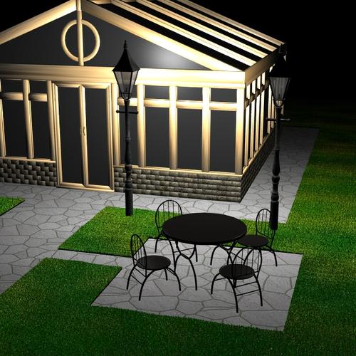

  • GoneGone Posts: 833
    If you are using the AoA grass shader, you can create any path style you want easily.
    Create a ground plane and use your path texture on it. Create a geometry shell of the ground plane and put the grass shader on it. In a paint program, paint whatever path style you want (white for grass, black for path) and drop it in the displacement channel of the geometry shell.
    The path will show through the black painted areas.
    800 x 450 - 184K
    Thank you for explaining this. I had a look through the menus and found out how to create a geometry shell, I think I'll have a go at this.
    And thank you all for the nice compliments. Yes, it is fun finding out what you can do in Daz Studio.

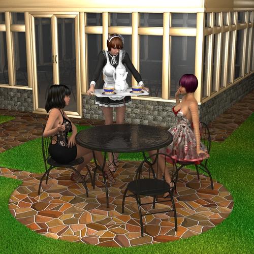

    I had a go at the geometry shell and displacement mask method. It's a bit more work but it gives you total control of the grass shape.
    I rendered the top view camera to get a template for drawing the mask, that way I can just draw areas around the conservatory and the table and add the path.
    Here is render of the scene with some people added to make it more interesting. It's been fun and I've learnt a lot about Daz Studio doing this.
    600 x 600 - 363K
