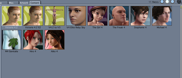

    The way you can tell V4 from V4.2 is the title in the Content browser. Just make sure you load a V4.2 and customize it with your base character and then save it to you objects browser as you normally would for future use.
    BTW, in the past I've saved a base V4 to the browser, loaded it into a scene and applied morphs to it from the Content browser and it works just fine.
